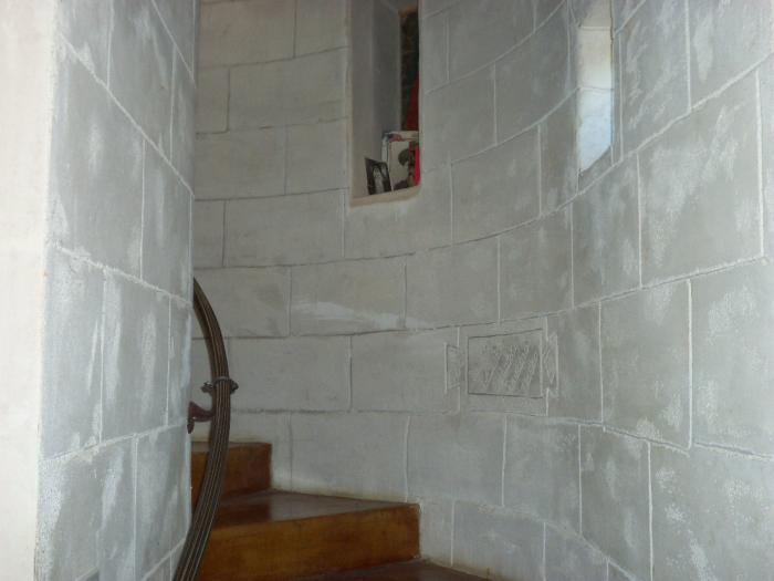

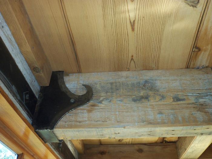

    Attachment 14191Attachment 14192
    Those precious beams were salvaged from a 1800's sawmill floor and are about 7x14". The span is actually less than 16 feet as I recall. and the next [2] floors up are exactly the same, but a dining room and bedroom with more of the beams. 2" concrete floors poured OVER them for radiant and fire protection. I would have used English oak, but its all in guarded parks now, and sunk in oceans after raping and pillaging the earth.
    The beams are load bearing, and the "decking" over them is 2"x24" sugar pine milled off the land.
    Good eye Cookie. That arch is a rather interesting construction - made a huge form on a slab, then made the window and door unit to fit just inside it. [ made the laminations deep enough so that I ended up witha second 'free' window after bandsawing it out - That would have made a good tv show] Then moved it to the site and erected it in one piece. I think its 16" deep. Bricked up the outer faces and filled the inside with massive amounts of steel. That missing part is to be a marble "keystone" with inscription. Never got to it.
    Had to do it that way to survive the next earthquake. Had quite a few already.
    The upper floors beams were done as coffered- a tribute to one great English technique.
    Added pics: Looks like it would hold an aquarium, eh mate? And the staircase, which is all stucco, should bring you right home Ian. Scratched the stucco until midnight with retarders and 2 or 3 bottles of wine.
    Those joist hangers are works of art too; love 'em!
