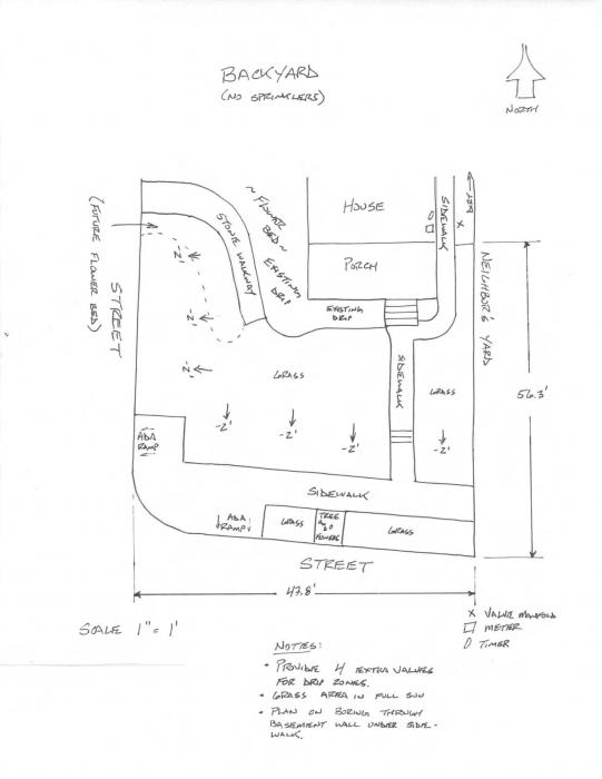

    Attached is my plan for the front yard. Couple zones perhaps? I sent it off to Rainbird and we'll see what they think.
    Name:  sprinkler front2.jpg
    Can someone please edit the title of the thread and remove the "-check my flow/pressure please." We're building on this now!

    it will be my guess that they will recomend three maybe four zones for the grass and one for the beds. as for valve placement a single manifold will likely be the recomendation.
