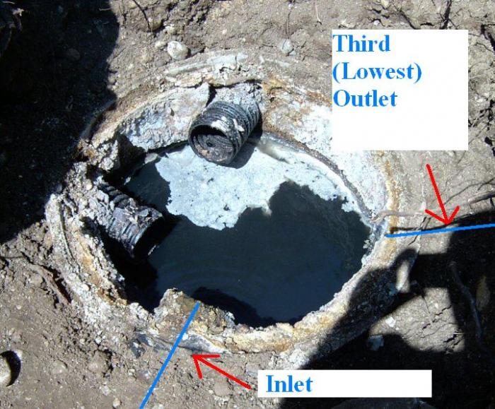

    I was able to start this project last week and got the concrete distribution box exposed. I was dismayed to find that while the cover was in good condition, the side walls are crumbling, and the whole box will have to be replaced. The cast iron inlet line, as expected, is almost completely blocked with rust and other rock-hard stuff and only allows a small trickle of water into the DB. Also, the individual lines to the leach field are all at different elevations, so that the line on the right receives nearly all of the effluent. The good news is that there weren't any tree roots in the DB and the outlet lines look to be in good condition. I haven't been able to get in touch with the guy who will be performing the repairs, so I'm just wondering what folks would suggest as a replacement - another concrete DB or plastic? The current one measures 28" in diameter and 21" deep.

    Quote Originally Posted by JAR8832 View Post
    I was able to start this project last week and got the concrete distribution box exposed. I was dismayed to find that while the cover was in good condition, the side walls are crumbling, and the whole box will have to be replaced ... wondering what folks would suggest as a replacement - another concrete DB or plastic? The current one measures 28" in diameter and 21" deep.
    A local code might specify one or the other, but either should do just fine. I would probably use a piece of 24"-round, double-wall, plastic pipe that is ribbed on the outside and smooth on the inside. Then, one 28" concrete lid can serve as a base and the other can go on top.
    A small trickle is very typical unless a bathtub or washing machine is presently dumping into the septic tank ... and if the tank and the D-box are fairly close together, replacing that line should not be very difficult.
    There is nothing terribly bad about that -- mine are the same -- and that can actually be a good thing. If just one of your lines is presently handling most or all of your load, that likely means it is in good condition and the other only has to serve as an overflow of sorts. Also, it is good for leach lines to be dormant for periods of time to dry out and "recover" a bit, so that means your second line is quite possibly in very good condition. As an experiment to see, plug the first line and let it rest for a few weeks while the other line does all the work. And since you are going to be getting a new D-box anyway, you might consider a diverter valve so you can switch lines every four or eight months (to give each line a taste of all seasons).

    Thanks for the reply. I discussed the situation with the master plumber who will be doing the work, and without seeing it first hand suggested placing a piece of large diameter sewer pip vertically inside the current DB, cutting holes for the inlet and outlet lines to pass through. He is concerned about digging up the old DB because it is technically part of the leach field. Hopefully he will stop out next week and clarify his approach, at which time I'll report back.
    The inlet pipe is in the process of clogging with rust again. From the looks of it, it would be completely blocked within a year. I tried to open it up a little, but the stuff inside is rock hard. At least I know all of the digging was worth while...
    Plugging the lowest outlet to test the other outlets sounds like a good idea. How would you suggest doing so? The outlet pipes are 4" corrugated flexible tubing. I'm not too keen on getting up close and personal with the effluent...
