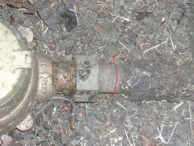

    Here's something I don't understand. I checked my water bill and it states "Rate Code /Service Size : RES_T_B 3/4 inch".
    But the connecting old galvanized pipe (from the house) size to the meter is 1" diam. When it comes out of the concrete it's reduced to 3/4" when connecting to the copper pipe from the house.
    Name:  Main - old galvanized pipe size.jpg
    I called the water company and the lady just followed my account profile and said I needed a 3/4" pipe connecting to the meter.
    But I wonder about the reason the Service Size states 3/4" when the galvanized connecting service pipe size is 1"?

    If you have a two or three bath home, you should have a 1" service to the home with your 3/4" meter.
    Only if you have a one bath home would a 3/4" service make any kind of sense.
    The larger pipe size reduces friction at very little cost on the upgrade, which is noticeable to the homeowner when the plumbing fixtures are used. It's better to oversize a service then to undersize it. If you have two baths, then 1" is the correct size.

    3/4 is the meter size. Many water utilities base your fee off the size of the meter and the actual water usage.
    I would sleeve the pipe only where it goes under the slab.
