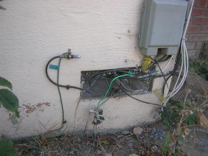

    Name:  water main - house entry.jpg

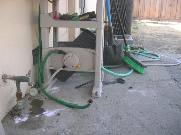

    I've just done a water test. Static pressure is 60 psi at the house entry, but turning on each faucet would cause a drop of 10 psi. So, turning on the tub, kitchen faucet, and the hose bib in the front yard take the pressure at the house entry down to 30 psi (!)
    I guess that's good enough indication it's a water flow issue at the main water pipe?
    ** This house is a 55 yrs old house, so I'd also need to consider if the main water pipe is being used as the ground (cannot replace with PVC if so?)

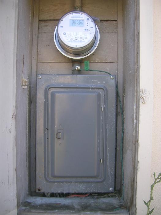

    I do see copper pipes inside the house are also used as ground although there might already be a ground rod somewhere -- but I don't see any except one small rod used only by the cable company (see pics of electrical box and ground rod).
    Name:  ground rod - cable.jpg
Size:  65.8 KBName:  electrical box.jpg
    Seems like the pipe thru' the electrical meter is used as ground. Don't know if anyone knows enough to explain that... .

    The drop in dynamic (while actually using water) pressure is caused by inadequate flow rates. Flow rates are affected by the size of the pipe, how many bends (elbows, or other restrictions), distance traveled, and elevation changes. There are tables that help to calculate the pressure drop over distance with various pipe diameters. And, you'd have (slightly) less pressure on the second floor bathroom verses the first, but the primary thing is supply line size and condition. 60# is a decent pressure. Anything over 80# should be regulated to 80# or less. Some people with a well live with the range of 20/40, so 60# is fine, if you can improve your flowrates.

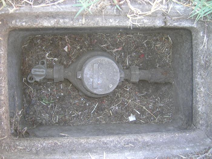

    I think the main line coming to the house entry is 3/4" galvanized pipe. By the meter, I can even strip off the surface off that pipe--exposing some rusted part.

    As far as the grounding -- if you go with PVC, you'll need a new ground rod. Actually, they asked me to put in one even though I was going with copper.

    I called the Water Company telling them about the low water pressure problem when turning on faucets.
    The technician came out and did an actual test:
    - removed the water meter to my house
    - he had a short 2' S pipe section set up so to reroute the Main line (from the street) where it originally meets the meter upward
    - reconnected the rerouted pipe section to the water meter
    - turned on water from main full blast thru' the meter, and timed the water amount that came out in 1 min
    Water meter hooked up to house service pipe : 1.4 circle turn on water meter
    Rerouted test : 5.4 circles turn on water meter
    He said the water flow thru' the current service main (galvanized) line to the house was about 0.93 gallon/min from the test.
    W/o going thru' the galvanized pipe, the water volume would be about almost 4 times more.
    Looks like this confirms it's the galvanized pipe that's restricting the water flow (volume) problem.
