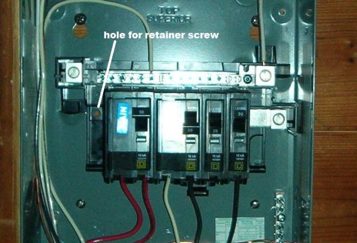

Question: Do you have any idea where I can get the breaker retainer you had informed me about being needed in my panel?
From the manufacturer of the panel if that panel is designed to accept one. It may be that the panel has been discontinued and will need to be replaced with a newer model in order to tie the breaker down.
