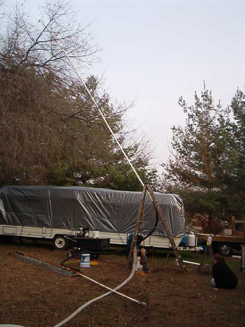

    work on electricity barefooted and you'll look worse than that photo you post.
    That photo you mention is not bad at all if you might happen to know and acknowledge the actual facts of the matter ...
