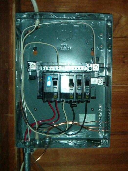

    I have a 30-amp feed going back to my detached workshop, and here is the load center in the workshop ...
    I have a great-working old 120V arc welder that needs 30 amps ...
    http://books.google.com/books?id=8v2...welder&f=false
    Question: Can I put a 120V 30A breaker in my shop's loader center that has a 240V 30A main breaker?
    If I do that for the welder, I would use a NEMA L5-30P plug and receptacle just for the welder.

    You can install the breaker, but you have what appears to be another problem. Is there a green screw next to the white wire in the top right corner of the panel in your photo?

    Quote Originally Posted by ActionDave View Post
    You can install the breaker ...
    That is good to know, and I thank you.
    ... but you have what appears to be another problem. Is there a green screw next to the white wire in the top right corner of the panel in your photo?
    No, but you definitely got me up out of my seat to go take a look! That screw is silver and just happens to appear green in that picture, and it holds the commons bar to that lug. The bonding screw is laying in the bottom of the panel, and it would go in the spot just above the screw you have asked about.

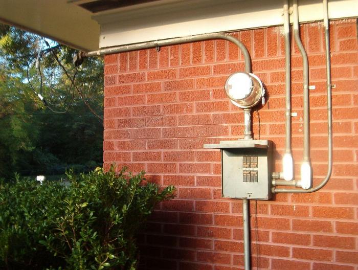

    Edit: Here is the rest of my story ...
    The house has an old 60A XO panel directly behind the meter, and then the former homeowner added the exterior panel with 240V breakers for the workshop, dryer, AC and stove with everything still being fed by the original 60A service with #8 wire at the eave!
    We are presently on an electrician's project list to have our service entrance upgraded, and I will likely wait until then before doing very much with my welder even though all is well in the workshop.

    The back fed 30 amp breaker needs to be tied to the panel.
    You are correct your service needs attention

    Quote Originally Posted by jwelectric View Post
    You are talking about some kind of retainer for the main in the workshop, correct? I do not know what part I need to do that, but I do plan to ask the electrician about that when he comes out to update our service entrance.

    There is no equipment grounding conductor installed with the feeder to that panel and no bonding in the panel so therefore any and all equipment grounding conductors in the small panel is mute.
    Either install an equipment grounding conductor with the feeders or bond the neutral and equipment grounding conductors in the small panel to give the fault current somewhere to go. Personally I would install an equipment grounding conductor with the feeders

    I think you mean "moot". Obviously the metal conduit did not provide a ground path sufficient to trip the breaker. I'm surprised you went so easy on lee with such a blatantly hazardous situation.

    That tickle could just as easily been enough to stop your heart! Never work on electricity in your bare feet.
    I do understand the safety issues there, and my bare feet in this case had to do with my assumption the ground rod was doing more than it is apparently doing.
    The ground rod is primarily for protection during lightening strikes...don't count on it for an effective ground.
    I actually knew it was for lightning, and I am going to have to get the idea of it being an overall catchall out of my head. I thank you.
    I understand, and I thank you.
    Question #1: What about this from early-on here ...
    You can install the breaker, but you have what appears to be another problem. Is there a green screw next to the white wire in the top-right corner of the panel in your photo?
    If I am understanding correctly, bonding that small panel in my workshop is not a good idea since a problem at the house could send stray current on down the line and leave a heart-stopping tingle waiting on my metal switch cover.
    Question #2: Would an equipment grounding conductor along with the feeders actually be any better than what I already have? It seems to me that the problem I had yesterday would still be possible since the ground rod at the house is likely no better than the one at the workshop.
    We used to have that kind of problem here, but he has learned there is just no need!
    The conduit coming into the workshop is plastic, and it goes to a junction box since the feed was too short to reach the panel. So, the metal conduit you see is only grounded to the workshop's new ground rod ... and all of this work got started because I was getting a tickle from the table saw. When I first got to this house a little over a year ago, only one leg of the feed and the feed's neutral came into a receptacle on the wall and then there was a spider's nightmare going out from there. I ultimately discovered three of four receptacles with the black and white reversed, and someone had used a 3-way switch with one terminal going to ground (even though there really was no ground anywhere) for the old fluorescent light over the workbench.
