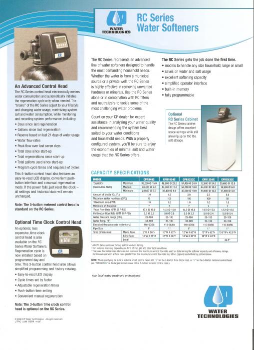

    Then why would a supplier of water softener or filters put the flow rate through the equipment.
    6,356
    A.... Through the softener is the only flow that counts, not the SFR gpm of the control valve.
    I can't read the data in the picture, the print is too small and enlarging it makes it fuzzier. So do another copy and enlarge it at higher quality.
    Then find out what CV (flow at 1 psi drop) 5.0 means and you'll know how to correctly size softeners.
