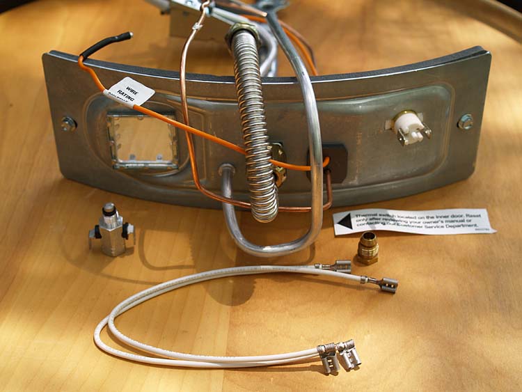

Here we go. The part arrived today and I immediately snapped some pictures of the parts. I uploaded them, but I don't know how to get them to appear as inline images. In previewing this message the images show up in a list below the text and you will need to click on them.
The BFG Conversion Kit showed up in a 10"x10"x10" box delivered by DHL. It contained a replacement plastic filter (two pieces) for the base of the water heater, a new manifold/door assembly, thermocouple adapter, ferule nut, two wire leads and a sticker to apply to the heater.
The first image should be a view of the entire BFG kit with parts, laid out generally where the parts go. Note that the viewing window is now square and a bit larger than the old style. The thermocouple adapter can be seen on the left in front of the viewing window. The piece on the right is a thermal switch. The wire leads attach to the thermocouple adapter and the thermal switch. The thermal switch is apparently a thermal breaker. My assumption is that it is supposed to pop before the thermocouple burns out. The only way I can see that it works is on the same principle as the igniter wire system--when it gets too hot the switch pops and sends an electric current to the thermocouple adapter, which shuts off the pilot light and burner. The sticker attaches to the water heater, just to the right of the manifold and thermal switch. There's probably a federal law that this sticker has to be attached.

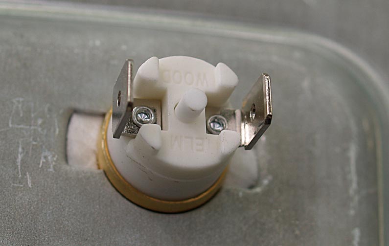

The second image is a closeup of the thermal switch. The little white button in the center is the reset switch.

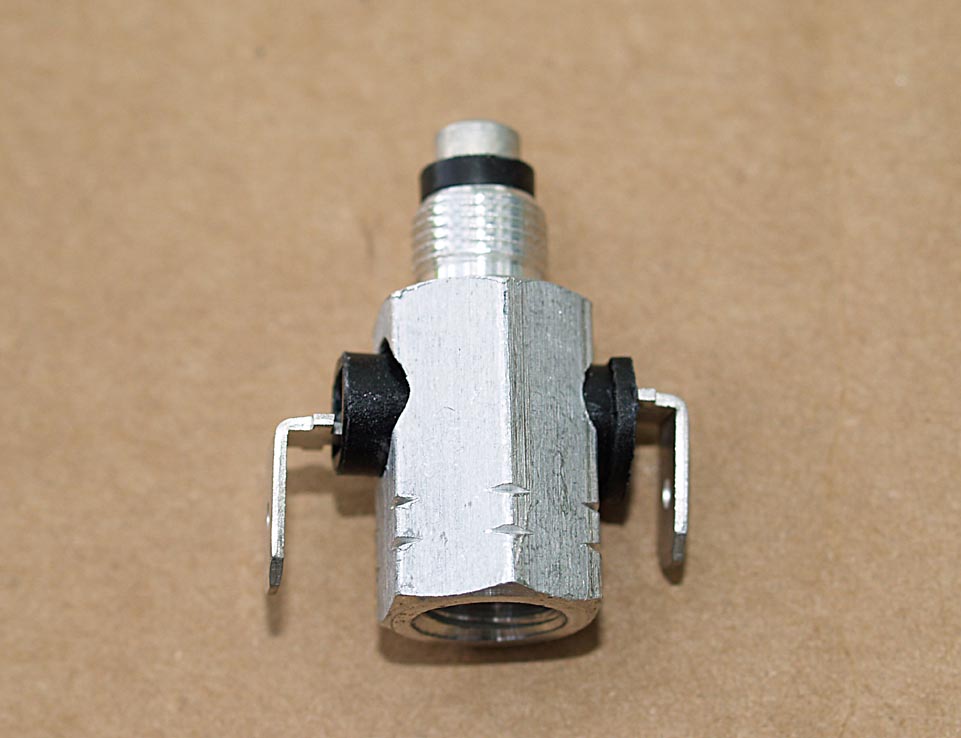

The third image is a closeup of the thermocouple adapter. It attaches to the thermostat, and the thermocouple attaches to the adapter.

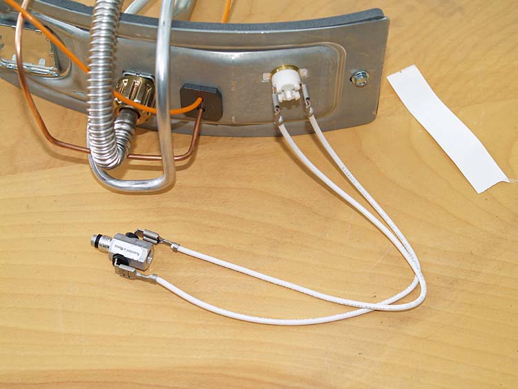

The fourth image just shows how the thermocouple adapter connects to the thermal switch. The wire leads have straight-on connectors for the thermocouple adapter side, and flag connectors (same connector, but at a 90* angle) for the thermal switch.
The installation process is pretty straightforward. Remove the old manifold and burner, remove the burner and attach it to the new manifold, reinstall. Connect the external wires and tubes, then connect the wire leads between the thermocouple adapter and thermal switch. Ignite using the standard procedures. If the thermal switch pops, it can be reset by depressing the white switch in the center. The "BFG Conversion Kit - Manual Addendum" contains the following statement:
"IMPORTANT: This water heater has a resettable thermal switch installed as part of the FVIR Safety System. DO NOT attempt to disable or modify this feature in any way."
The kit looks complete, but I'm not sure how the ferule nut is going to seal the pilot light gas tube when I attach it. The ferule nut freely slides over the pilot tube. It seems to me that there should be another part for the tube and nut to compress against. Hopefully, it is inside the fitting in the thermostat. If anyone can explain how this functions, please let me know. I'm familiar with flare fittings, and have used compression fittings but I seem to remember that second part for a compression fitting. All that's left now it the installation. I'll let everyone know how that goes.

That ferrule you are talking about is a break-away ferrule. Just place it on the aluminum tubing then insert the tubing and ferrule into the control as far as possible. Then once you proceed to tighten the nut the ferrule will break away from the nut, setting it to the tubing.

Thanks for the PICS.....
they have not addressed the amount of air this unit
is able to take in ,,,,and cannot ......
so my bet is the thermal switch will keep poppping out
untill it starts to give out due to being tripped too many times.....
....when it starts to overheat....due to poor air combustion

That was my thought, too. I think the thermal switch is just a piezoelectric fuse that is designed to pop before the thermocouple burns out--kind of like a fuse for a fuse. [sarcasm]Now that's the good old American ingenuity that made this country great [/sarcasm]
I wonder if the thermocoupling is of the same design and shorts out too when it gets too hot??? Does it still look the same to you??
Funny you should mention that. I haven't gotten around to installing the new kit yet, but after I read your post I screwed the thermocouple onto the thermocouple adapter. The threads were standard threads. I thought for sure that the threads on all the previous thermocouples were reverse threaded, so I went out to the trash and, risking old food and other rubbish I dug around and pulled out the old thermocouple. I couldn't get it to thread onto the thermocouple adapter at all, left or right. So the guess from this non-plumber is that the thermocouple adapter has reverse threads on the male end, and standard threads on the female end. This leads me to believe that any standard thermocouple should work on this water heater as long as the thermocouple adapter has been installed first. I'd like to get a hold of an extra thermocouple adapter to play around with. It would be interesting to see how it reacts when various voltages are sent through it. The instructions state that it doesn't matter how the leads between the thermocouple adapter and thermal switch are connected, and nothing is color-coded.
Come to think of it, if the problem is with the thermocouple itself, shouldn't the thermocouple adapter alone be sufficient, as any thermocouple will now work? If so, why is the switch even needed?

The thermocouple is definitely different from the previous thermocouples in that the threads are no longer reverse threaded. The thermocouple adapter does have reverse threads on the thermostat control side, and standard threads on the thermocouple side.
This pretty much confirms my theory that the thermal reset switch is nothing more than a fuse for a fuse. We'll see how long it lasts. Elmwood makes the thermal switch, and it will be interesting to see if they start catching hell from customers when the switch wears out. One thing I wish I did (but didn't think of at the time) before I installed the new manifold kit was look at the thermal switch to see how it is attached and if it can be replaced. In looking at the unit from the outside, it looks like it's not a threaded on piece, held on by a nut. So if the switch wears out, it might mean replacing the entire manifold door assembly unless it's a pop-out part. I'm tending toward the replace the entire manifold assembly theory because the instructions that came with the kit has a parts list that includes everything but the thermal switch. The thermal switch shows up as part of the manifold door assembly for both the natural gas and LP gas parts. Has to be Whirlpool scheming on how they can continue to get money out of us. Since they redesigned the manifold door, they could just as easily designed it so that the thermal switch was a part that could be replaced.

The thermocouple adapter is the key to the whole operation here. I have never bought a thermocouple before I got this water heater, so I don't know how many different ones there are. But I remember the first time I went to Lowe's after it burned out the first time they pointed me to a "standard" thermocouple that had standard threads before I told them it was a Whirlpool Flame Lock water heater. I don't know how much cheaper, if at all a standard thermocouple is. But if it's just a few bucks then it's still cheaper than paying shipping for a new manifold assembly or $15 for the reverse threaded thermocouple.
