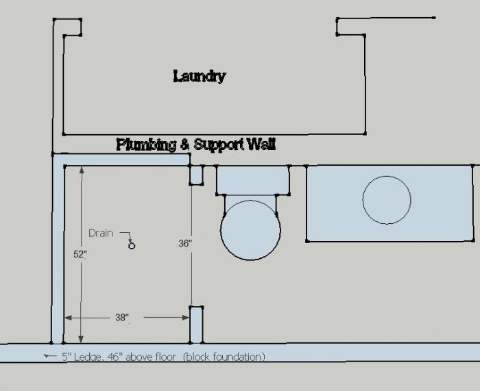

    I don’t have firm plans yet. This grew from tracking down a leak on the other side of the wall, which has plumbing for laundry, outside faucet as well as a bath above. I expect the downstairs was left unfinished by the original builders and done DIY at a later date. They had a fiberglass shower surround basically unattached to the house drain with some odd framing to support it as it was somewhat smaller than the space available. Before firming up the new shower plans I wanted to make sure of what is available and what I’ll need to deal with so I don’t overreach or plan something undoable. At some point we did intend to redo this bath, just not this soon. So I’d like to have something that will work with future renovation of the rest of the bath too. The toilet is kind of awkwardly situated. It looks worse in the sketch than reality but does seem to preclude a door rather than curtain without making some bigger changes.Name:  Shower.jpg
    The drain is off center by a couple inches which I figured would cause grief with a prebuilt pan, and it seems a tiled shower as big as possible in the space would be nicer which is what led to me to figure on making a mud/tile pan.

    ...So my general idea for this shower is still pretty flexible and definitely open to suggestion and advice. I was planning a basic mud pan – like is shown on various how-to sites and books: preslope, rubber liner, final mortar with a 3 piece drain and tile. I can certainly see the advantage to using a material like Kerdi or Nobel and am considering that once I look a bit more at price and availability/shipping. Along with the mud pan I figured on using concrete board/wonder board with plastic behind for the walls. The space above the ledge from the foundation blocks just seemed a natural spot to have space for a decent sized nook. I’m aware as an outside wall it’ll be colder, but the same wall in the bathroom doesn’t have issues with that and it’ll allow for a slightly deeper nook. I expected to build that along the lines of several how-to’s, size somewhat depending on what we choose for the tile. I was wondering if fiberglassing the 2x4 and plywood box might make for better waterproofing, but I’m not sure how tile would do with that. On the same wall I was thinking of a narrowish (10”) bench, built in with the pan ending at it’s base. I understand too what jadnashua is saying and haven’t ruled out using a premade bench and/or nook insert too...
    There is nothing wrong with a good old fashioned mud bed. This is the most common form of shower construction here in North America - if you believe all the online posts and blogs you would think the art of mud bed shower has died. It has not.
    Main concerns here with this type of install is having a pre-sloped base under the liner so when the flood testing is done all the water drains away.
    Next big one is protecting the liner from damage while installing the 4-1 or 5-1 cement-sand ratio over the liner with expanded metal lath.
    If you take care and have a pre-slope, don't puncture the linear your good to go UNLESS you forgot to protect the weep holes from clogging.
    Slopping a shower floor with an Old School Mud bed is like playing at the beach. Fun and not to hard.
    Mixing the dry pack (4-1, 5-1) is straight forward and can be done right beside the shower on grade or idealy in a mud box. I use my mixer first and then switch to a Garden Hoe.
    This system is the most cost effective and most likely the easiest for you to track down materials. Buy fresh Cement CHECK CHECK CHECK!!! Clean Washed Sand. Or perhaps Mapei's 4-1 premix if you can get it.
    Up from this method of shower construction you can streamline steps, lower elevations, speed up the process or not.
    Do you have access to Kerdi, Nobel, Mapei, Latecrete etc in Alaska? Might be worth it to call on a few tile stores and find out the costs of these items in your neck of the woods.
    JW
