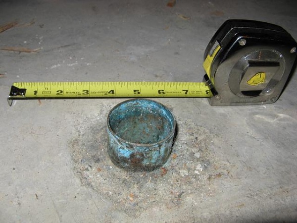

    I’m replacing a leaking fiberglass shower with a custom tiled one in my basement. The old one is all ripped out and I am down to concrete floor with a 2” copper drain pipe extending up about 1 ¼”.) I can’t seem to find a suitable drain. They all seem to be too big. They seem designed to fit larger (and PVC, not copper) drain pipe, and also seem to be at least 4” high.
    If I use some kind of adapter to change from copper to PVC I’ll be making the drain even higher.
    It seems a drain sort of like used for bathtubs, that slips down inside with a sealing collar would be great. But I haven’t seen anything like that suitable for a tiled shower, with weepholes.
    Is there some solution short of chopping out the embedding concrete floor?

    No, there is not, unless you want to end up with a ridiculously high shower floor. Showers require special drains, and there is a bit involved in figuring where to
    place them, along with all the other details of shower construction.

    Most bathtubs are piped with copper it seems in high rise projects around Vancouver. In most private homes I see cast iron or ABS.
    Connecting to an old copper line is so simple. You can get "No-Hub, MJ, Fernco" fittings that will fit over the copper pipe and then tie into 2" lines. They are labelled with funny code like ' 2" copper to 2" ABS/PVC ' and available online or at any good plumbing wholesaler. I have about 4-6 of every kind in my van.
    It's nice to lower the vertical section of pipe and this can be done with a pipe cutter designed to enter a pipe and cut or by removing more concrete and using regular methods.
    With your drain set up as is we could install a new three piece clamping drain in about one hour. If the hole was wide open about 10 minutes.
    You could install a Proline Drain from Quick Drain USA with a 2" - 2" copper MJ.

    What I’m hearing is I’m going to have to break out some concrete around my drain pipe, even for drains like the Proline or ACO (which I hadn’t considered but do look great). Like many projects this started as “just” a little leak and keeps growing in size and scope at each new revelation. I’d hoped to avoid breaking out the concrete to not only avoid that extra work and potential for a new round of issues, but also the risk of damaging the embedded copper drain. But of course I want to do it right – I sure don’t want to have to revisit it or leave a mess for someone else down the road. This is what I've got, 2" copper coming up about 1 1/4 inches Name:  IMG_5557.JPG

    Sometimes, you really need to tear up the concrete. It's hard to say, but the copper line (and trap?) could be corroded. The only way to find out is to tear some concrete up. You'll need to make your connection below where you currently have access in order to keep the pan height reasonable, and, in the process, you'll be able to see the condition of the piping buried there.

    DanaK I mean to the water in the pipe - the water level inside of the buried P-Trap.
    Is there 3" from the slab to that level? Is there 7".
    Copper is pretty soft material and easily cut.
    You can see an "No-Hub" fitting in the hole. That is a 1 1/2" copper to 2" ABS/PVC fitting.

    If it was me and we had 4-6" of vertical pipe above the concrete subfloor to the top level of water in the PTrap we would be chipping concrete to lower the fitting. I use my Grinder and a diamond blade to score many lines. Careful to stay away from the 2" copper pipe. Once we have scored our lines a small cold chisel and hammer will pop these out.
    Do not send downward blows when chipping. Sideways blows away from the pipe will not stress it. A 2" copper pipe set in concrete is strong. Think about the shape of an egg and a submarine. Your busting concrete not icing a cake so use care within reason - by sending the blows away from the pipe you can ramp up your agression and bang that stuff out.
    Don't let your kids watch as cement flys everywhere and there ears and eyes don't need the damage. The grinder is messy. Get a mask and a shop vac. We like to add extra shop vac hose to the exhaust and swing that outside the home.
    I own a 1" demo hammer (a dwalt) sometimes if we are chipping a line for a trench drain we drill many holes and then use te grinder for a clean line and the demo hammer to chip.
    If your just getting the old 2" copper line to a new drain you won't need to do so much work.

    The nominal thickness of the setting bed above the liner is around 1.5", then add the thickness of the tile and the anchoring thinset. Underneath the liner, as mentioned, about 3/4" over a slab is good, although on a slab (but not on a wooden subfloor), you can get by with less. If you use a surface membrane (like Kerdi) and their special drain, the drain would end up about that minimum of 3/4" above the slab, though, and provide the lowest floor (at least verses a traditional liner shower) as a surface membrane does not use a drain with weepholes since the membrane makes it the waterproof layer.
