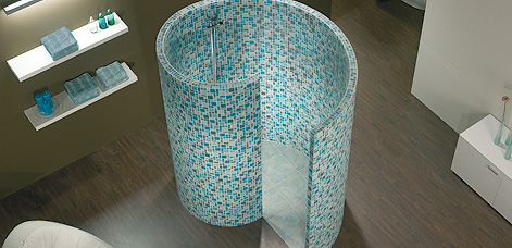

    I'm doing a quick google on tiled showers.....and unless my eyes are playing tricks, I am seeing some really nice custom showers but no doors if not a shower rod in sight.
    Showers are a very Wet environment.
    Am I missing something but are walk in showers being built - designed - without nary a door or liner to ~enclose~ the water overspray ?
    19,214
    Yes, but it takes some careful designwork to ensure no problems. Personally, the draft can be a problem. One of the neatest is one of the kits by Wedi - its a free-standing scroll.
