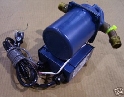

    I use this Taco recirculation pump to bring hot water through a long run laying in the attic (installed after the line in the slab had failed):
    Name:  taco recirc.jpg
    In my application, it gets powered and self-starts every time the bathroom light is turned on, and it does not put any noticeable amount of even tepid water into the cold line being used as a return. When the attic is cold, it runs for about 10 seconds ... and then for only one or two seconds when the attic is hot. If you do not want it to start every time someone enters the bathroom and turns on the light (like I have it wired), it has the option of being powered all the time (self-starting only once) and then being manually started via use of its trigger wire (if you supply the SPST momentary switch or a proximity sensor that might need its own power).
    On my favorite auction site, a search for "taco pump" can lead to finding one for about $60.00.
