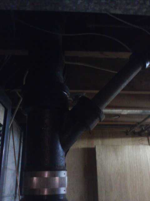

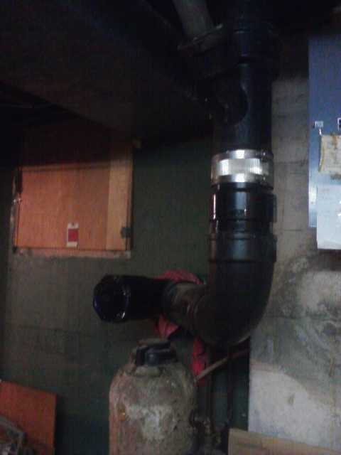

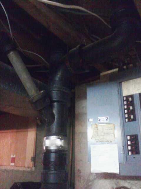

    Hi there,
    I've been lurking on the forums for awhile now without registering and haven't been able to figure out how I'm going to be able to do what I want. The sewer drain goes out of the basement wall about 4 feet up from the basement floor. I want to add a kitchenette, so basically just a sink, to the basement for convenience but how would I set it up to drain? Do I have to put in an ejector pump set up for just a sink or is there an alternative that would work?
    Here's the layout that I was thinking. Obviously, black = walls.
    Here's how the drain currently looks.
    The drain connector here comes from the upstairs kitchen sink. Which I'm planning on using the vent from that sink for the new sink in the basement.

    Consultant cwhyu2's Avatar
    Aug 2007
    Cincinnati OH
    1,271
    You could use an under sink pump,if it is for limited use.
    www.hartell.com LTA is one to search for on the site.
