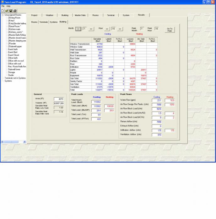

    Here's a breakdown for the amount of glass we have planned: of the entire exterior (vertical) surface of our house, 65% is insulated walls, 28% is insulated-glass windows and 7% is butted-glass windows. So it's 35% glass right now.
    Yes, I entered into Taco real glass U values of .355 (Cardinal low-E 366, as an example). (The ACH is .5/hr.) I have not tried changing the amount of glass yet, but I will - it will be interesting to see what it takes, even though we won't be able to lop much glass off when it gets right down to it. But I did try a few things: 1) increasing the walls from the current R18 to R24 reduced the load only ~2K, 2) decreasing the glass U value from .355 to .27 saves 3K cooling and 6K heating, 3) dropping the U to Taco's lowest allowable of .24 drops another 1K cooling and 1K heating. So that last effort takes us from the original numbers of 115K cooling/109K heating down to 109K cooling/100K heating - not very compelling.
    I'm pasting a jpeg of the Taco result page below, but since I'm not sure it will display I'll say a couple things about two big numbers that are biting us, one for cooling and the other for heating:
    You probably are used to looking at their results table, but I'm not. a) The window solar contribution to the cooling load is 40K, but as far as I can tell Taco isn't taking everything into account (for instance, we have a lot of ENE glass, but we'll have exterior shades for summer mornings - I accounted for that in Taco by putting in huge overhangs but saw no change in this number. Also, our south glass has proper overhangs to mitigate solar gain in summer. West glass area is minimal.). b) The ventilation contribution to the heating load is 40K, a really big number, but I don't understand what it is - there's already an infiltration number of 9K. (Ventilation adds 8K to the cooling load.)

    Do a passive and adjust the valves and temp of the water to the REALITY of the built house.
    I would'nt get tied up in programs details very deeply. You have already identified many flaws.
