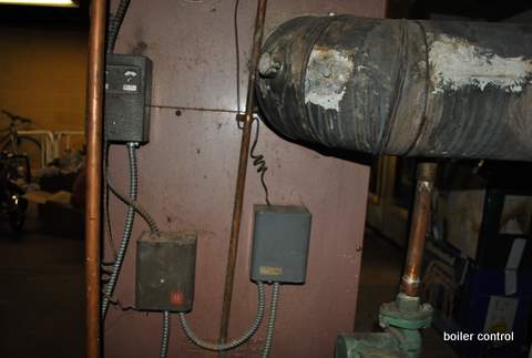

    I got an old American Standard Arcoliner oil fired boiler w/ tankless coil for DHW which we just converted to a 40 gal electric hot water heater.
    The coil is cut off - so no water feeds into it, the pipes have been rerouted to the water heater.
    However I still have the boiler on - I don't want to shut it down for the off season in fear of it not starting back up in winter.
    The plumber turned the control on the low side all the way down (100).
    I hear the boiler kick in once in a while - not as much as before though, since we are not calling for hot water through the coil anymore.
    My question is - should I just shut it down for the summer?
    Is there a way to adjust the controls to stop the boiler from maintaining the temperature for the coil part of the boiler?
    The plumber took one look at the inside of the controls and recommended to leave it alone.
    I take it in the winter the boiler will be running alot anyway and won't be kicking on often to keep the domestic water hot.
    Any suggestions would be appreciated.

    You can remove the wire from the low limit side of the aquastat which will keep the oiler from maintaining temperature however that old boiler is at least 50 years old and closer to 70 and it was assembled with push nipples so there is a good chance it will leak when it goes cold. The best thing you could do with it is send it to the scrap yard. A new boiler will save you a good 20% on your heating bill and probably closer to 40% Those old Arco's were pigs. The flue passages are big enough to toss a cat through. Does it still have the original Arco burner hung on it?

    Dana, from the picture and the age of the controls I would bet that the IBR input is 140,000. Now I'd bet that it's not fired at anywhere near that but when you down fire an old boiler with big flue passages it is another thing that leads to good looking combustion efficiency numbers because it gives lower stack temperatures.
    To the OP. If you are not willing to change the boiler, my advice would be to turn the low limit down and walk away from the pig. It's not worth putting a dime into in either parts or labor.

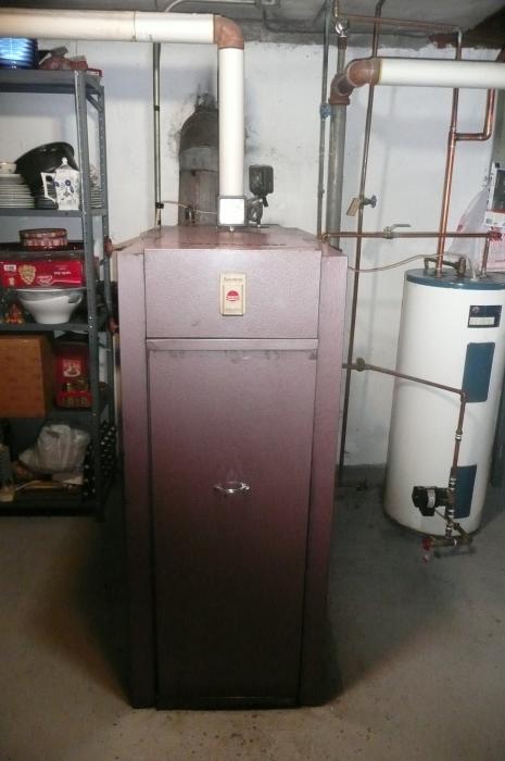

    DIY Senior Member wallygater's Avatar
    Dec 2007
    long island
    133
    Default I have the same boiler
    Yes it is old. I think mine is about 60 years old. Yes it is a beast, about yhe size of a voltswagon bug. The one that I have is the same color. It is a steam boiler and has been working very well all of these years. Original everything. New oil gun. And it still produces the DHW through the origial built in coil. And yes, the rust inside this thing is unbelivable.

    They're out there! I know several homes with steam boilers even older & far more decrepit than yours that still in operation. But at the current fuel prices there's not much sense in keeping them around. You're likely getting no better than 50% AFUE out of it during the heating season, whereas newer steam boilers will run an AFUE of 75% or better (some even hit the low-80s.) It might cost 6-8grand to swap it out, but a new one would cut your fuel use by more than 35%, maybe even half. (But in a L.I. climate a heat pump solution might be a better investment, even if it's more money.)
    BTW: It looks like you're using the DHW coil as the heat source for an indirect tank. That's somewhat more efficient if you run the boiler only at low temp during the summer (or cold-start it), but if you're keeping the boiler at 150-160F your net HW heating efficiency is probably sub-25%.

    Hey Dana, I sure wish you lived on long Island. That goes for the rest of you pro`s out there.
    My old steam boiler is heating the house very nicely. no banging, no problems. From what I hear, In order to replace it many things need to be taken into consideration. To big is no good, and to small is no good. It needs to be sized just right according to the house and the radiators.
    I have read a lot about near boiler piping, and apparently, if that is not done correctly I will be wishing I had my old boiler back. Also, the new boilers are very small and don't have anywhere near the heat retention that the old has, due to its huge mass of iron.
    I do love the indirect DHW tank idea. That would be a dream come true. What you see in the picture is only a holding tank, and it sucks. The boiler is still making all the DHW, and it disgusts me that it has to pass thru that 70 year old rusted up coil. Just to add some insult to injury, my chimney is also in bad shape. It needs to be re-pointed, its missing some bricks on the top, the mortar slope thing from the top is long gone, and it is in way overdue mode for a SS liner. My plan is to do the chimney first. Before the whole thing collapses on me. Hopefully, heating oil will some day come back down. I use about a 1000 gal per year.
