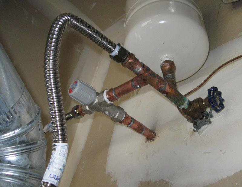

If you have a big tub in the home, they like to see a tempering valve.
And yes, you can adjust the outgoing temperature, it's a mix from the cold and the hot.
This way you can run the heater with a high setting, and then dial down the output.
You can also tap off before the tempering valve to places that can utilize hotter water safely, such as the dishwasher and washing machine (if you still use hot there).
Bradford White has a neat packaged add-on tempering valve that you just screw on. They also have a digital temperature control that easily lets you change the temperature output. As part of that package, you can also add a leak detection/water shutoff device.
Where I live, a tempering valve is required to get a permit and inspection of a new or replacement WH.

The 'guts' of a tempering valve is essentially a bi-metalic spring - same sort of thing that was in the old, mechanical thermostats for your furnace. They can last a very long time. As the spring gets weaker, you can tweak it a little until at some point it needs to be either replaced or rebuilt. The one I have has an allen key hole in it to enable you to turn it. I just leave the wrench in it, but have not actually ever had to adjust it. There are some with a calibrated knob, but they cost more and I'm not sure they actually work better or longer. I'd think if you used it a lot, you might cause the seals to start to leak...they are more of a set and forget type of thing.
One thing I like about the BW bits is it's easy to set a time limit on raising the temp. The worst thing to happen would be if it was raised, and then someone else needed to run hot and scalded themselves. The nice thing about a tempering valve is that if you need more hot water, you can raise the tank thermostat and still not have to worry about scalding anyone...it just mixes more cold to maintain the same temp.
