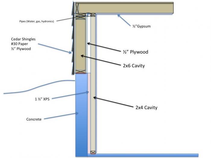

    Hello all - remodeling basement in 100+ year old Seattle house. Basement was 'finished' when we bought 15 years ago - though musty, and generally not well done - nothing really square or plumb. Now we're tearing into it to create a 'mancave' for the teenager, his friends, guitars, etc.
    The issue is insulation. I've read extensively on the buildingscience.com website and am trying to hew to their recommendations as closely as possible.
    A couple issues:
    The wall construction is concrete wall at varying height - it gets lower with the grade, from about 6' at highest to about 3.5' at shortest. There is a 2x6 pony wall of similarly varying (inversely) height atop that.
    When the house was built, 1x6 shiplap was attached to the inside of the 2x6 pony wall, and on the outside, metal lath directly on the 2x6 wall, with concrete stucco. This construction had degraded over the years and had allowed water in/trapped water in numerous places resulting in sill plate rot. I've removed the stucco all around, and replaced the compromised sill with new treated wood and a gasket, and replaced studs as needed. Outside is now clad in 1/2" plywood, building paper, and soon, cedar shingles. My question is how to insulate the pony wall.
    I'm adhering 1.5" XPS to the concrete, to avoid condensation. (Previous 'finishing' was no insulation, and internal 2x4 wall up against the concrete wall - there was rot in places on the floor, and mold, though I think this was ground water - and I've regraded the outside and added a French drain, and injected urethane foam into some cracks).
    I plan to frame internally with 2x4, and use unfaced fiberglass in the stud bays of the new internal framing.
    I think I want to spray foam the band joist space to 1-2"; there will be additional fiberglass behind that - we're adding radiant tubing to the joist bays for the first floor, there will be insulation below this, and I was going to turn the batts up at the ends, behind the new spray foam.
    What is unresolved is the 2x6 pony wall. In reading here and other places, I'm thinking a layer of foam (1"?) on the inside face of the 1/2" plywood exterior sheathing, followed by fiberglass, or just fiberglass? Should I insulate the pony wall, and not the internal framing? I'm thinking that the goal needs to be suitable total R value, though keeping the fiberglass from reaching dewpoint of interior air, and thus condensing, creating mold-growing potential.

    What I meant by the layering I described was a description of a possible approach to the pony wall insulation, from the outside -> inward.
    I was intending to run the non-structural 2x4 wall from floor to ceiling, so the cross sections would go like this (from outside ->in):
    at pony wall level: cedar shingle / paper / 1/2 plywood / 2x6 cavity / 1/2 plywood / 2x4 cavity / gypsum / latex paint
    -the question here is what insulation in 2x6 cavity, whether to use a vapor retarder under the inner plywood, and what insulation in 2x4 cavity.
    at concrete wall level: concrete / 1.5" XPS / 2x4 cavity / gypsum/ latex paint

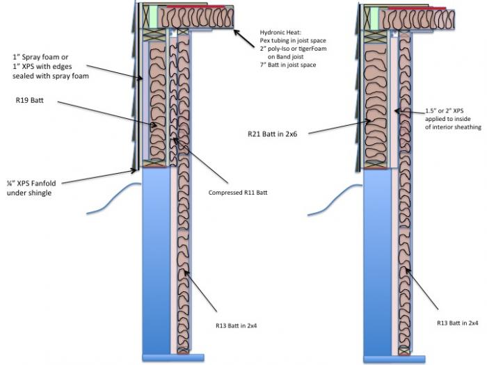

    To help me understand, I've drawn some pictures (see below). The first is just the wall as presently constructed (showing shingles which are not yet applied, though)
    The second shows two possibilities as I understand your discussion.
    It seems simpler to go with the one on the right - no exterior fanfold XPS, no spray foam in the cavity; with R21 FG in the 2x6 space and R13 FG in the 2x4 cavity, and 2" of rigid XPS applied to the interior face of the sheathing.
    I had been thinking about spray foam in the 2x6 cavity, on the interior side of the exterior sheathing, but that seems both expensive and messy for a first-time DIYer like myself. I like the simplicity of gluing and sealing XPS boards to the plywood.
    I was considering the spray foam (with the above trepidation) for the band joist space - or using foil-faced poly-Iso pieces cut to fit and sealed with canned foam.

    You've take the 1000 words and made the pretty picture, and methinks you've interpreted it right!
    The one on the right is definitely fewer steps,an probably less expensive.
    A few details to attend to for preventing air infiltration and/or convection losses & thermal bypasses:
    When installing the interior plywood, put a bead of caulk on the framing at the edges as you nail it up to make it air tight.
    Leave a 1/2-1" gap between the upper XPS and lower XPS at the top of the foundation, filling it with 1 part foam (or a small FrothPak kit). The XPS can be glued in place with foam-board construction adhesive to both the concrete and the plywood, tacked lightly in place the plywood with a few nails as you go. Try to keep them as co-planar as possible, since that affects the fit & function of the 2x4 studwall insulation.
    Seal the top of the XPS to the plywood in your plumbing & electrical channel to prevent convection currents in the thin space between the XPS and the plywood using either foam board construction adhesive or spray foam.
    Don't forget to use a sill gasket under the bottom plate of the 2x4 studwall between the plate and the slab. A bead of caulk under the plate also prevents air leakage under the plate into the wall.
    If there's a big gap (more than 1/4") between the studs and the XPS, use unfaced R19 batts rather than R13 or R11 batts. Compressed to 3.5" an R19 batt will be ~R13, but it will have sufficient loft to not leave a convection path in the gap whereas an R13 batt wouldn't have a tight fit.
    Use air-tight techniques on the interior gypsum board too (beads of caulk between the framing & gypsum as you put it up, foam seal around any electrical or plumbing penetrations, etc.)
