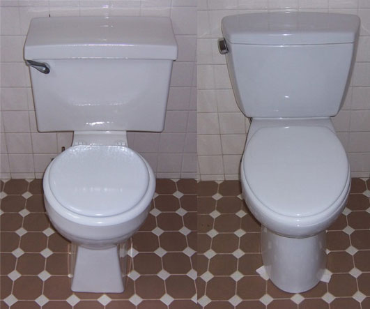

    12,427
    The raised seats leave too much without a rinse.
    They're horrible.
    It would be better to use a riser, better yet to replace the bowl.
    Though sometimes you don't have many options.
    Wall hung bowls can't be easily raised up, so it's easier to use a taller seat on those.
    I do sell plenty of ADA bowls now.
    The one on the right is an ADA bowl by Toto
