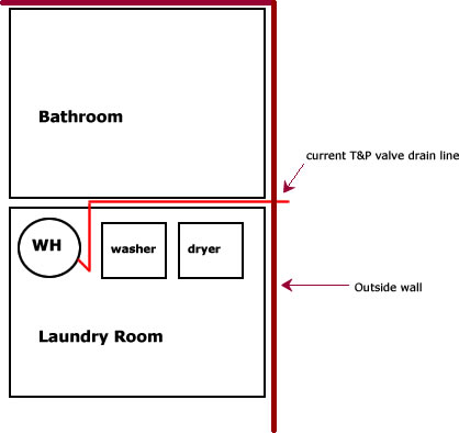

A basic layout of the room is attached. It's a single story home with no basement. WH is located in a laundry room with no in floor drain.
I've looked at my local plumbing codes, which are just local adjustments to the 2009 IPC and nothing is noted about this in it. I think I may give them a call on Monday to ask about it specifically.

So you're saying regardless of what the code or city says is acceptable I should have two separate drain lines; one for the drain pan and one for the T/P valve?
The current T/P line is 3/4". City code says that the drain pan line must be 1".
