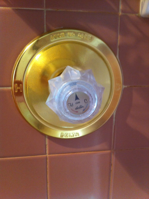

    23,547
    The single handle is the 602 series. The two handle is 2852, 2702, or 2650 depending on the handle style and whether it has round or square escutcheons, but they all use the same body and operating parts.

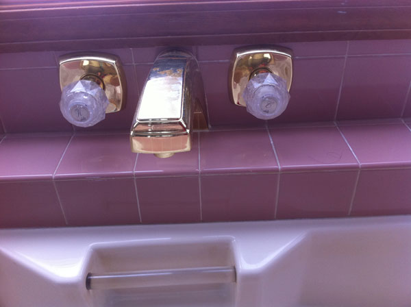

    and the shower:

    23,547
    The square escutcheons make it the 2702 valve body, but with a unique tub only spout. What are you trying to accomplish?
