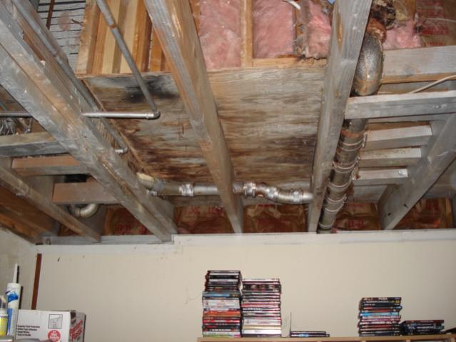

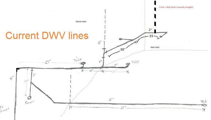

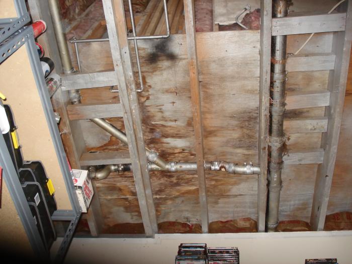

    So I'm in the process of remodeling a main bathroom. I've almost finished tearing it down to the studs (and joists) and am currently finalizing plans to put everything back together. The thing I've been most anxious about is the plumbing. Not because it's not functional, but because once I remove the corroded cast iron and replace it with PVC it will have to meet the new code. Seems I can't just replace pipe for pipe, and nor do I want to because if something can be done better, that's the way I want to do it. I've done lots of reading but a lot of the info seems to leak out of my ears overnight leaving me with a lack of confidence about my plans.
    I've attached a sketch of my layout. The downstairs ceiling is gone, so I pretty much have access to everything. I would greatly appreciate any feedback on the drawing and potential issues that need to be corrected.

    1. Unless you have a very deep joist space you will not be able to install the two toilets that way, under ANY codes.
    2. The lavatory drains are NOT vented properly and one sink flows past the opening for the second one.

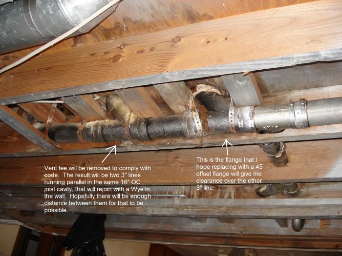

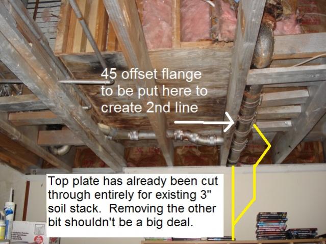

    Sorry for being unclear, this drawing is a layout of my existing installation, so that's the way those two toilets are currently installed. The installers used 2x2 furring strips on the bottom of these 4-5 joists underneath these DWV lines. So that made them 2x10 instead of 2x8. I think I'll probably have to leave it this way because all of this runs over the downstairs living room. It also seems like the PVC flanges and elbows may be a little shallower than these big cast iron parts, so I'm hoping I can just replace them. If that's the case, is there a code violation?
    Thanks for the verification on the lavatory drains, I had pretty much assumed that was wrong. I'll do some reading and try to update my drawing with a possible correction.

    I think the 45 flange should have plenty of space to get the 2nd line to the other side of the cavity.

    To install the toilets the way you show it would require that they be connected to sanitary tees on their backs, which is ILLEGAL under all codes. To use the proper fittings in that configuration would require a VERY THICK floor, probably at least 15". Getting the "knowledge of the proper way to do it" is WHY plumbers have to go to school as long as they do. Once we have that, THEN we can come to your house and decide the BEST WAY to install the piping, NOT just redo what is existing, which as you know, may NOT be a proper installation. You still have NOT addressed the problem of the right hand sink drain water flowing past the left one, which does NOT have a proper vent.

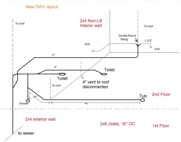

    I've updated my original sketch to include modifications. I've also noted some questionable fittings. Can someone please let me know if this meets code? Particularly the low heel?

    Can anyone give their thoughts on the new layout? Any code issues?

    Look, you have a mess there, one helluva mess in fact and though I feel your pain in the wallet, you really need to get some pro's in there. As good as we are, there are just too many variables to be able to give confident advice to you. Anything we might come up with is just going to be a best guess estimate.

    Well, HJ weighed in somewhat but his comments seem to re-inforce my own and I suspect that getting any of us to give you much help is probably not going to happen. We can tell you things like san-tee's can't be used horizontally to recieve the discharge of waste and such things but again, you have a real mess there that pretty much needs to be torn out and re-done and that is pretty involved.
