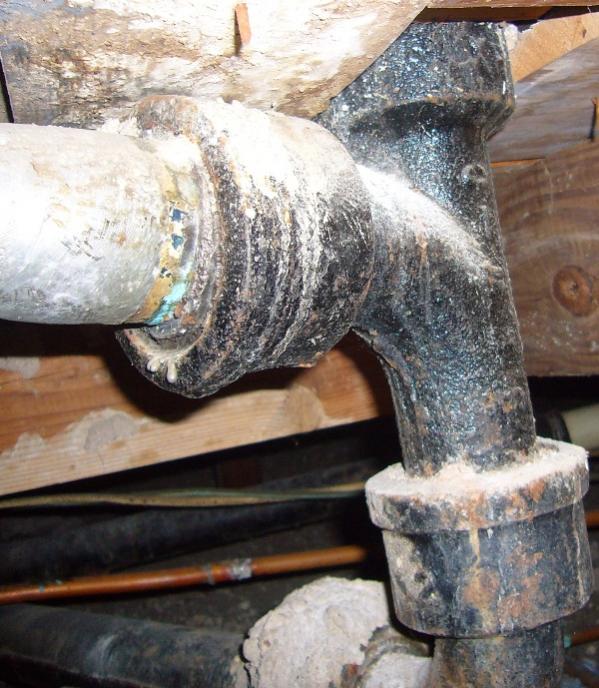

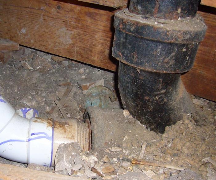

I am about to tear into some 1926 plumbing to replace an old drum trap on a bathtub. Lead pipe ties the drum trap to a cast iron t-fitting, but I can't figure out how the joint is made at the tee, and before cutting out the lead pipe I'd like to have a plan to transition to new PVC. The image below shows the joint, and it appears to be lead to brass, then all soldered into the cast iron hub. Could this be a threaded brass fitting into the cast iron, or is it a lead and oakum joint? Or is it some Frankenstein creation? There was some previous remodel work done where they tied into the old cast iron with a threaded PVC fitting, but it appears that it was at an old cleanout (second image).
Bottom line is, what is the best way to approach tying PVC into this cast iron tee? It's all in about a 16" crawl space, and replacing the tee doesn't seem like a very easy option. Any advice or insight would be appreciated.
-Bryan
Previous remodel:
I think, but am not sure, that there's a brass stub leaded into the hub, then the lead pipe is sweated onto that brass. If so, then you'd remove all the lead, then use a rubber donut (made by Fernco among others) inside the cleaned out hub with a piece of PVC jammed into the middle of the donut. It is crucial to get the proper sized donut so there's enough pressure on it, but not so much that you can't get it inserted. They come in small increments to match the hub.

Your first pic is wiped lead joint and you can cut it out.
Your cast iron look okay.

That be a brass caulking ferrul which transitions from C.I. to Lead pipe. You can remove all of it from the C.I. bell using a combination of a 1/4" chisel and a hammer. Go easy, don't chip the cast. If you have a sawzall you can chop the lead off real close to the C.I. and then go with the sawzall, inside the bell, paralel and make a couple of cuts through the ferrul and lead. Again, don't cut the C.I.

You'd probably have to search for the proper nohub fitting, too, as the OD of the brass ferrule is not the same as the OD of say PVC. And, you'd have to get it clean and smooth enough to make a seal - might be a pain with the leaded joints involved.
A leaded fitting has oakum jammed into the joint, then liquid lead is poured on top of it, then the whole thing is again rammed tight (not the true plumbing technical terms here). Note, doing one on the horizontal takes some special skills!
To take it out, you either melt the lead out, or drill out enough (can you say swiss cheese?) so you can then work the pipe back and forth to pull the whole mess out of there. There may be other methods, but those are the two I know of.

here is what you do,cut the lead about 4 inches from the hub,there will be a brass ferrule sticking out of hub.get a torch and heat ferrule,wipe it clean with a scratch pad.you should have about 2inches of brass sticking out of hub.get a no hub coupling and repipe.

In 1926 cast iron pipe had few standards other than the o.d. and i.d. Your hub could fit a rubber donut or not, or it could have "ridges" where the two pieces of the mold fit together. They would not have affected a lead joint but would make it impossible to seal a donut into it.
