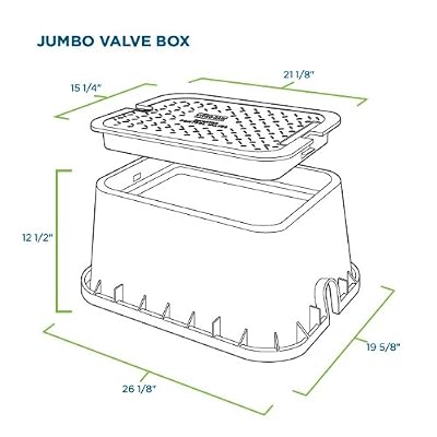

    I'm going to get one of those mega boxes but let me know if there is another alternative:

    I've been rethinking my plan and looking for advice. If I use this valve box, which is the only one I was able to find that is big enough for all the valves, it will stick out of the ground about 6". My other option is to put two normal size valve boxes down.
    In order to address this the original installer put one regular valve box for the 4 left valves and one of the round shut off box for the remaining two - leaving zero room to work on them.
    What's my best option here? I feel like the top of the box should be flush with grade.

    If you want to get the box deeper you can either notch the sides of it and it will fit over the lines or you could remove the valve setup and dig the hole deeper. You would need to extend the feed to the valve manifold. As far as the boxes I would use either two large boxes or one jumbo and a large. The small round one is too small to work in as you have found out. I like to use pre made threaded manifolds so I can add extensions between each set of four valves and each set has its own box. Looks like you have a glued up pvc manifold that is home made which is fine but it is not fun when it comes to removing valves for servicing. Here is a link to a typical valve manifold.....
    http://www.sprinklerwarehouse.com/Sp...folds-s/38.htm
