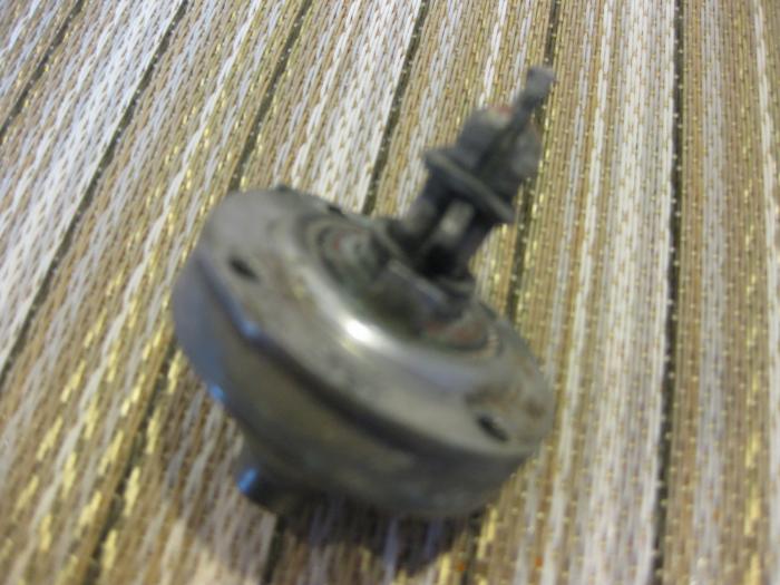

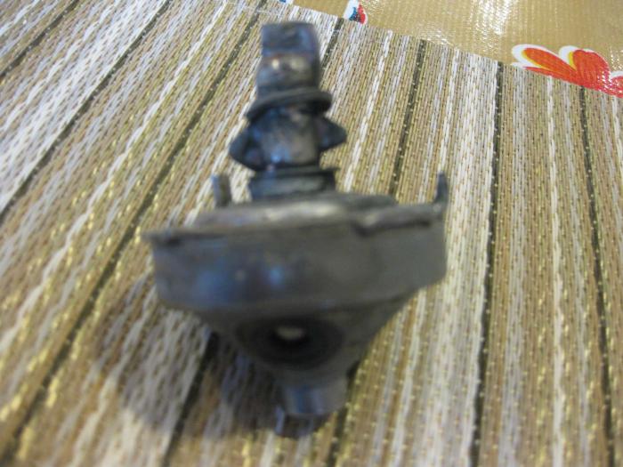

    Hi,
    I am unable to identify the manufacturer of the shower faucets in two of the bathrooms in my house. My house was built in 1964 and I assume that these are the original bath/shower faucets.
    The cartridge has the following written on it:
    US Pat 2923315
    708 M.F.

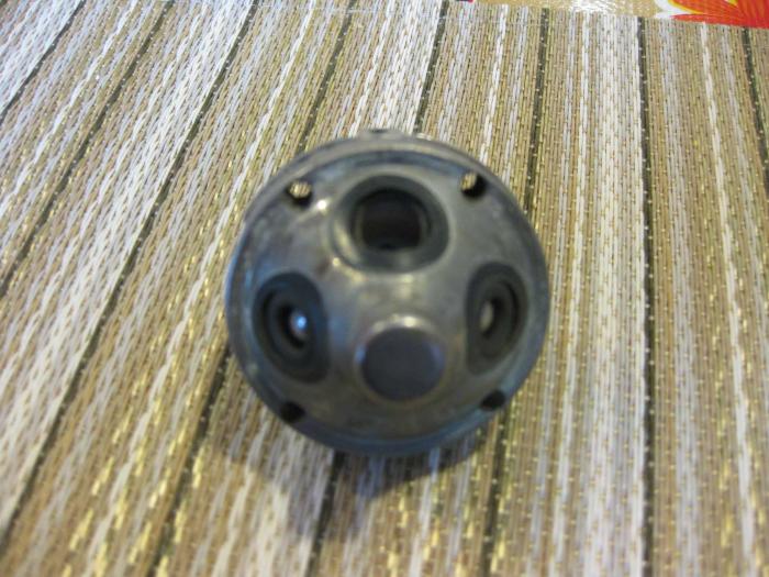

    I have two of these tub/shower faucets, both are in need of cartridge replacement. The shower is in immediate need of cartridge replacement or I will need to tear up the shower to replace the faucet. I have attached two pictures of the cartridge, can anyone identify the brand?

    That shape is so distinctive that it should be easy to identify. Unfortunately, it has been decades since I last saw one like it and cannot remember the make. It might be ValTemp, but that is just a guess.

    My immpression is that it was used in a kitchen sink faucet. It was mounted on the rear of the valve body and had a lever handle attached to it. That was usually a feature of a Schaible faucet, but they used a different mechanism.
    25,605
    I am going out on a limb here, (and it was my first impression although, if I am correct, the part you have does not look like the part you will have to buy), because I cannot take a new cartridge apart without destroying it. I believe what you have there is PART of a Price Pfister "Flowmatic" cartridge. IF so, you cannot buy just that part, but need the entire operating unit. A picture of the valve's handle, and/or the valve in the wall, would verify that this is what you have.

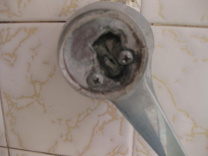

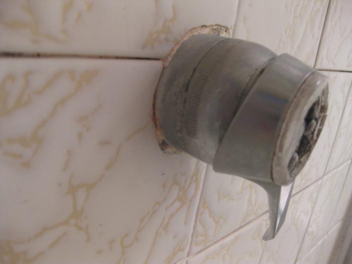

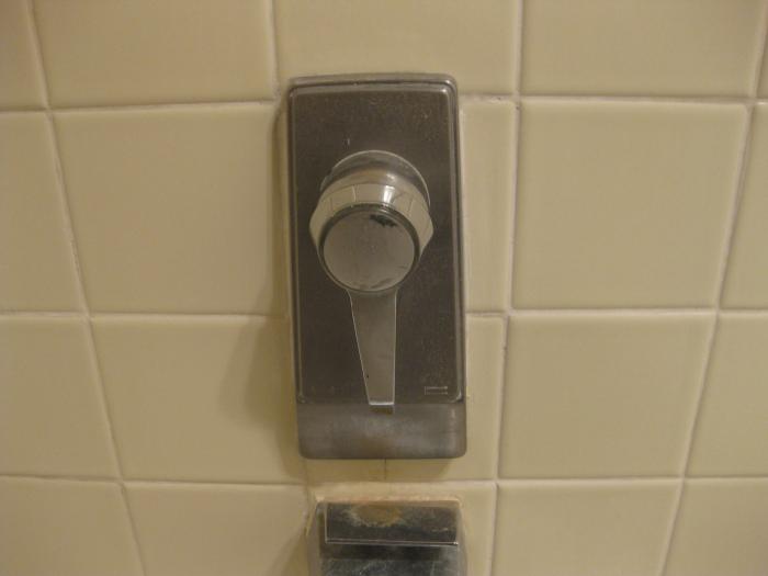

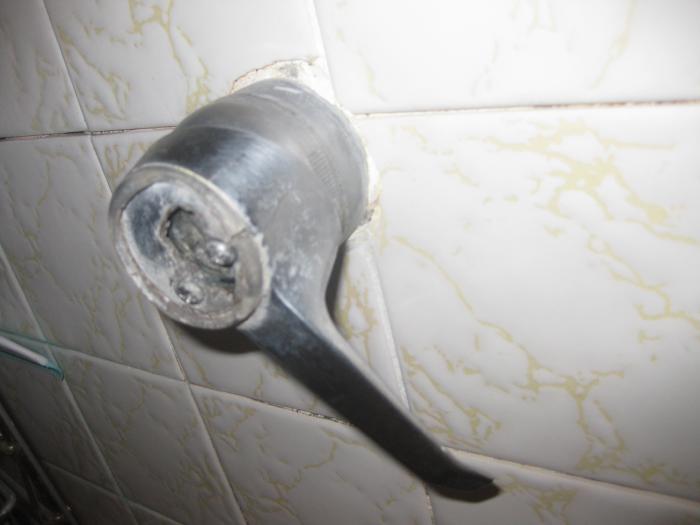

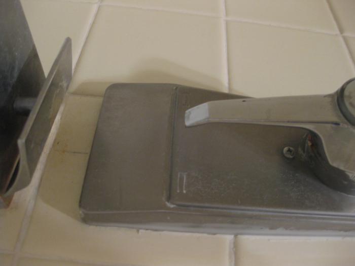

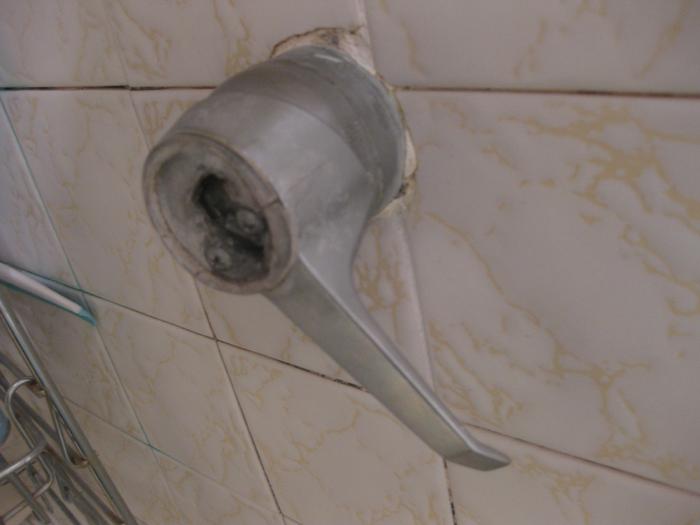

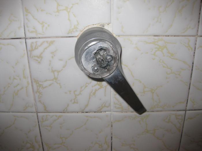

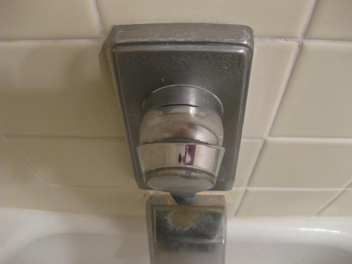

    I have taken pictures of the faucet handles of the shower and the bathtub. I will also attach more pictures of the cartridge or part of the cartridge.

    1. hj may be the only person on the planet to have ever seen the inside of a PP flowmatic cartridge.
    2. Having now seen your photos of the handle, etc, I think he will agree that it is not that.
    3. Thank you for the great photos! But it is a complete stranger to me! Someone will know what this is. Stay tuned.
    25,605
    Actually, the picture of the handle makes me even more positive it is a FlowMatic or some variation of it. The valve body will be the determining factor. The patent office site for the patent numbers does everything except display the text on the pages.
