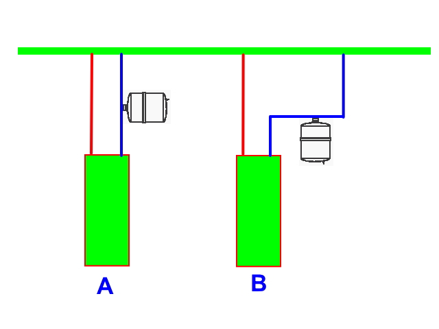

    Well, I live in a neighborhood about 15 years old. My next door neighbor's gas water heater just failed, as well as my neighbor across the street. Of course the builder didn't spend the extra nickel to put a pan and drain pipe under water heater so I am scared mine failing and damaging all kinds of stuff I have. I know how to sweat pipes and have actually installed a water heater in my old house, but haven't had to deal with expansion tanks, as they are new code requirement. So, I took a look at how my next door neighbor's water heater was installed by professional plumber. The plumber installed the expansion tank horizontally(tank horizontal attached to vertical pipe) which Watts literature says is okay - http://media.wattswater.com/2915054.pdf but only if you support the tank. He didn't, it is just hanging there screwed into T-fitting. I have 2 options to install expansion tank when I buy new water heater next week. If I install the expansion tank vertically, I would have to extend the cold water supply a few feet on the ceiling, and then drop it straight down and back to the water heater. Would that be the best way to install the expansion tank, or should I just install it horizontally? If I do install it horizontally, what is the proper way to brace the expansion tank, given that the support would have to come from the ceiling? The closest wall is a foot or so away and is concrete that I'd rather not tap into.

    Install it vertically. When installed horizontally and the bladder fails the tank fills with water and becomes to heavy to support itself.

    If you, or anyone else, installs an expansion tank horizontally, it MUST have a support of some kind fastened to the ceiling. The ONLY way to install it safely without a support is hanging downward from the pipe in a vertical orientation. If it is "upward" gravity will still try to break it off once it fills with water.

    Thanks for the replies. I had another thought on installing the expansion tank. Is there any reason why I shouldn't install it in the supply line strapped to the ceiling, like just before the elbow that brings the supply line down to the hot water heater? I don't see anything that says how near the water heater the expansion tank needs to be, so if I installed in the supply line on ceiling it would be probably 5-6 feet from the water tank connection.

    That is fine as long as it between the valve and the heater. You don't want to be able to isolate the tank from the heater by turning off the valve.

    You could strap it (the easier way normally), or build a shelf to set it on. Water weighs about 8#/gallon, so when it eventually fails, that's probably in the order of 25# or so hanging there. If it is hanging down, you won't spill much when you unscrew it. Sitting horizontal, it will dump some water when you unscrew it.

    If your pipes are a the ceiling and run across the floor joints, center the tank between joints and strap it to the joints on each side. Somewhat like your Plan B drawing except the tank would be at ceiling height. Plan A would require designing a platform or some kind of support to the tank. No point in doing that.

    I like the idea of just strapping it all to the ceiling joists. I'll put new shutoff valve just upstream of it too. I know it will be a bit awkward to get at the shutoff valve in this setup, but not like I need to get at the shutoff a bunch of times every year anyway! My wife thinks I am over engineering this and installing the expansion tank horizontally even if it failed and filled with water would be no big deal. That's probably true, but there must be a good reason why the manufacturer says don't do this unless supported properly.

    The tanks are made of a light weight steel and can sear off at the point of connection when the bladder fails and the tank fills with water.

    New water heater in including expansion tank. Expansion tank seems to have resolved our issue when we initially turned on shower would be a big rush of water, and then it would settle down to static pressure. Thanks all!
