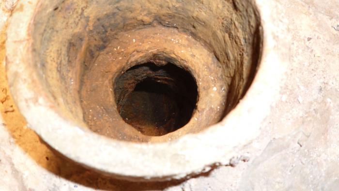

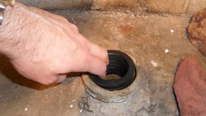

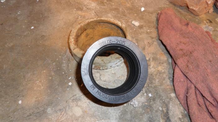

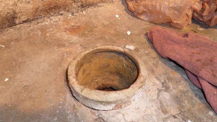

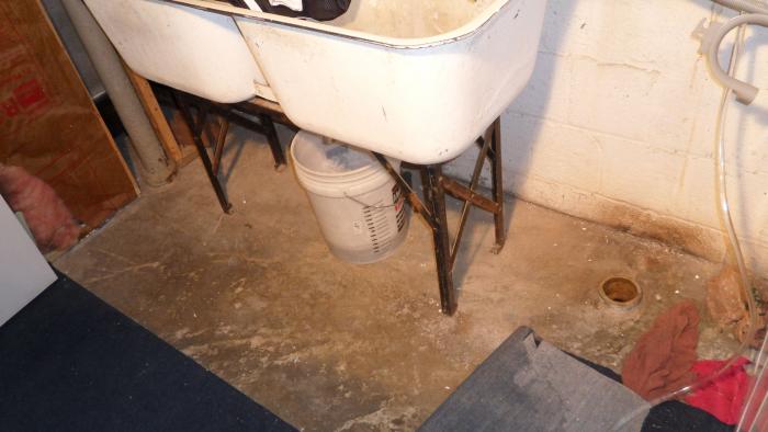

    I've got a 2" cast iron hub sticking out of the ground. Above the hub was a galvanized steel system joined with lead and oakum. The steel was at the end of its life, and I am looking to replace with PVC. The joint is out, but none of the Fernco donuts fit: I tried the SV size from the big box store, and special ordered the XH size (P/N 22UX-205). But it's still too small. The ID of the hub is about 3 1/4", which according to the rep at Fernco is in-between sizes, making a donut not an option.
    I think the most painless solution is to buy a short section of cast iron, and remake a lead/oakum joint, then attach with a rubber coupling to PVC. But I have some unknowns:
    1. Does the cast iron look to be in good enough shape for this?
    2. Is the lead/oakum something an ambitious DIY'er can do? I can weld and solder, and am not afraid to do a little research and get my hands dirty.
    Thanks in advance!
    -Vic

    Did you try the rubber insert with a piece of PVC stuck into it, because the pipe expands the rubber. If so and it's still too loose you can get a caulking ferrule from any plumbing supply house.

    Thanks for the reply! I did try the rubber insert with the PVC already sleeved, and it was still fairly loose. What's the scoop on caulking ferrules? Do they provide a leak-tight seal? I wonder if they're allowed by Code (I'm under the International Plumber's Code in my area.)

    They are legal and arguably the best way to transition to PVC
    23,511
    A piece of 2" pipe, (cast iron or steel), with a lead/oakum joint is MORE than adequate for your purpose.

    Inserting ANYTHING into a cast iron hub is done the same way. You place it in position, pack oakum around it leaving about a 1" space above it, melt the proper amount of lead, pour it into the joint, then hammer the lead tight with inside and outside calking irons. Most "ferrules" are threaded which is not always the best way to transition to plastic.

    Thanks all for the replies. I'm leaning heavily towards the cast iron stub, with a lead/oakum joint. Just gotta find a supply store locally that'll cut me off a few inches of 2" cast iron...or I'll just have 9'8" of "extra" pipe laying around
    I've read that you can lead directly onto PVC, but I imagine that there's more skill to that, since you have to keep the temperature of the lead low enough to not melt the PVC. Looks like PVC's melting point has a pretty wide range, and lead's is within that range.

    quote; Looks like PVC's melting point has a pretty wide range, and lead's is within that range.
    Maybe so, but hot water will "soften" PVC very rapidly and molten lead is a LOT hotter than that. Cast iron joints cast before the advent of rubber "donuts" did not necessarily have to conform to any rigid standards, (in fact before "spin casting" it did not even have to be concentric), which means a rubber donut may, or may not, fit it perfectly, plus you have to clean the interior of the hub very thoroughly to give it a smooth surface to seal to.

    Lead wool is not legal. To caulk PVC to c.i. you can avoid melting the ferrule by stuffing a wet rag into it when you make the pour. Some scorching will occur and you need to be well ventilated and do not breath those plastic fumes. Other than that the procedure is the same. Be sure the lead and plastic has cooled before you set the lead.

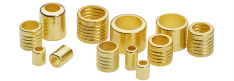

    If you go PVC install a PVC manhoff fitting (only found at a local plumbing supply store or online) into the hub first and then use oakum and lead or oakum and a LEAD SUBSTITUTE to seal the fitting into the cast hub...see images. Here, the PVC manhoff fitting is very thick and easily withstands the molten lead pour.
    You may also want to check with your local plumbing supply store and see if they have both the service weight type and extra heavy type donuts....betting the extra heavy (XH) donut will fit this hub...
    Questions? Let me know, OK?
