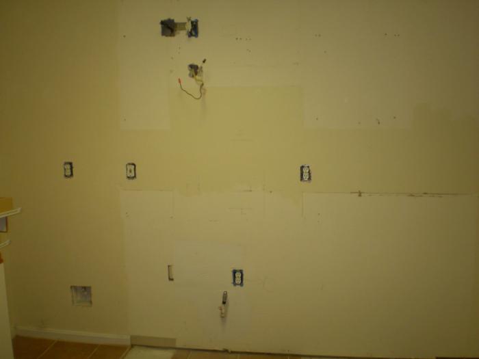

    MY main concern is liability. I surely do not want to be responsible for loss of life due to ignorance on my part. This is a kitchen re-do that just got out of hand due to poor builder craftsmanship. You wouldn't believe the electrical and plumbing faults I found behind that drywall. The whole thing snow balled on me.
    This is a dual wall with fire rated firewall (5/8") on either side with some additional panels added (previous crossover?) in between. There is a 3" air gap between the wall assemblies which I assume is for sound deadening. Fire rated QuietRock is going back up. It has sprinklers also.
    I was just confused about the whole thing until you educated me and for that I thank you immensely. It all makes perfect sense now but I just want to take a few extra steps. I now understand the differences in firewall design...
    I have just bought a house that has an attached garage and understand the firewall there. I will take it even further to not allow any fumes to enter the main house by sealing the garage off (no air leaks permitted).
    I will take a photo later today and show you how it was assembled.
    BTW- I am extremely anal if you haven't noticed.

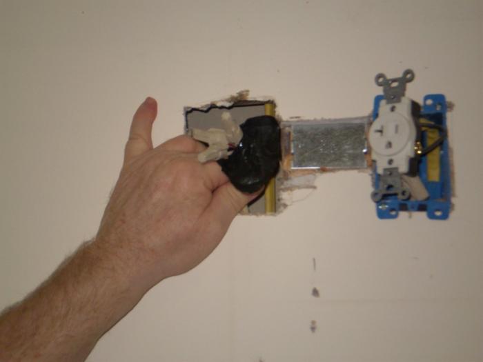

    You misunderstood as I did not fully explain due to resizing photos (still learning here also). I realize what it is you are saying, but this is the first thing I found after stripping the cabinets-
    There was an illegal junction point @ the 20A MW outlet. I finally figured the electrician didn't pull enough wire and had to add to the run. The range outlet was also on this dedicated circuit.
    The more drywall I pulled, the more surprises I came across.
    I am concerned the neighboring wall was not properly built as a firewall which explains (hopefully) my wanting to make my side tighter.
    Comments welcome.
