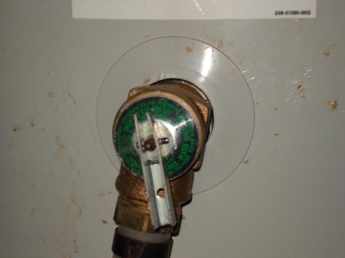

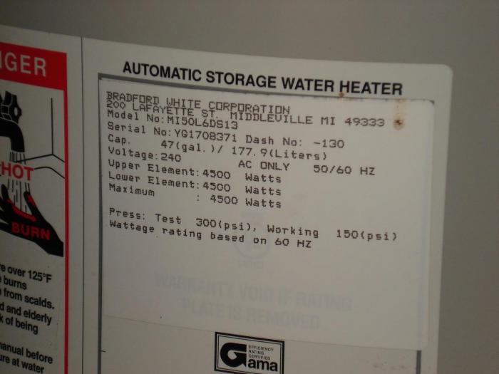

    I've got a 50 gallon low-boy that has been leaking for about 3 years. It's a Bradford-White or AO Sloan, not sure which. I never exactly knew where because it was so slow but in the past 6 months it got to the point where I could see an occasional drip from the temp & pressure valve drain pipe. I put a bucket there and it fills up with about 8 oz. of water in three weeks; it's enough to keep that area of the crawl space moist and moldy.

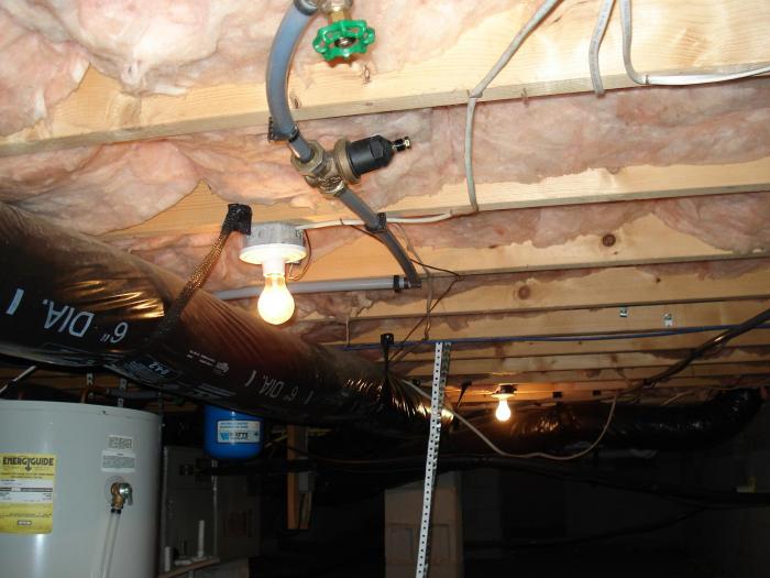

    As an experiment I adjusted the water pressure regulator valve by turning it three turns CCW. The valve has a plastic collar on the adjustment nut to keep it set at a preset point (see the attached pic). The valve body reads, "5 - 65 PSI" so I presume the setting is something like 45 because the water flow before adjusting was actually kind of weak; now, it's so weak the shower thing won't engage unless I hold it for a long time. Anyway, I turned down the pressure, set the bucket and a month later no water coming from the T&P valve.
    My water heater was repaired (if you can call it that) in 2008, which was near the end of its warranty period but still within it. Long story short, only parts were covered under the warranty ($29) but the labour was not ($135). I bring this up only because this incredibly slow drip coincidentally started about the same time my hero showed up and performed his 8 minute miracle repair.
    I've read from the experienced users that 80 psi is the max a household should have -- I am quite certain I am well below that. To give you an even better idea how low it already is, when I hook up one of those oscillating sprinklers it sticks in one position because there ain't enough pressure to keep it moving.
    So, that leaves temperature. I have never adjusted the thermostat on the low boy but I did check out the setting once repairs were made and it was and still is set to the exact middle of the dial. I don't know the exact water temp coming out but if you turn on the hot tap all the way you can keep your hand there and it won't get burned (but it is warm enough).
    Appreciate any comments.

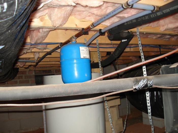

    It looks like you have an expansion tank already, its probably failed and that is more than likely the problem. I would still do the pressure checks though to make sure the prv is still working. It would be a good idea to change out the T&P valve as well. If doing this yourself use a bicycle pump to increase the air pressure in the new tank to your static water pressure.

    If the expansion tank has failed, it will be full of water. Tap on it and you should be able to tell if it is waterlogged by the sound. If it needs replacing, be careful when removing it as it will be fairly heavy. You will need a pressure gauge to adjust the PRV and expansion tank settings. They should be equal. Use a small hand air pump on the expansion tank. It's very easy to over inflate the tank because the volume of air needs is quite small and a big air compressor puts out too much air very quickly and that will easily rupture the bladder in the tank. It is possible the T/P needs replacing, but check the tank first.
    19,222
    Another quick verification of a failed expansion tank is that you'll get some water out when you try to test the air pressure, but being full of water is usually a big red flag. If the air valve is leaky, it's possible it just needs some air to recharge it. Note, though, that you can only check the air pressure when there's no water pressure on the other side, otherwise, the air pressure will be the same as the water pressure. So, to test and set the pressure in the expansion tank, you need to shut the water off, open a valve (any faucet will do) until there's no pressure, then measure the air pressure in the tank.

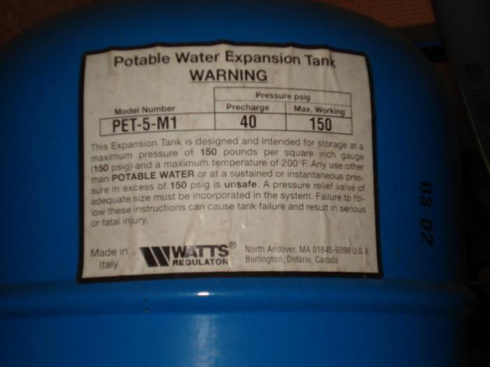

    I did not yet get a gauge with the peak needle but I have a gauge that I connected for the last two days. In the mornings, the pressure is reading 29 psi. When I come home from work, it's reading 40 psi and before I go to bed it's reading 41 psi. I also tapped my keys on the expansion tank and there is a high pitched plink plink and it actually feels very light (it's connected to pex), so I would presume there is very little or no water in that thing.

    It does work for the expansion of heated water. Normally those go on the incoming cold side.

    The PET-5 is for expansion, installed on the incoming cold.
    I've seen them installed on the hot side too, but it's harder on the rubber bladder in that location.

    When the WH runs, the expanding, heated water pushes all directions, so the location of the expansion tank, in theory, doesn't matter which side it is on, but, the manufacturers do NOT recommend them on the hot side - they last longer on the cold side. If you didn't have the PRV, you might not need the expansion tank. An expansion tank is specified when you have a 'closed' system (a PRV makes the system closed as does a check valve - some utilities install check valves on the supply to prevent potentially polluted water from getting pushed back into the area's supply).
    The fact that your pressure changes at all, indicates that either the PRV or the expansion tank is not working properly. WIth both working, it should be stable within say a pound or two all the time (unless your supply can't keep up with the demand, but when all valves are off, it should stay stable at the setting on the PRV).
