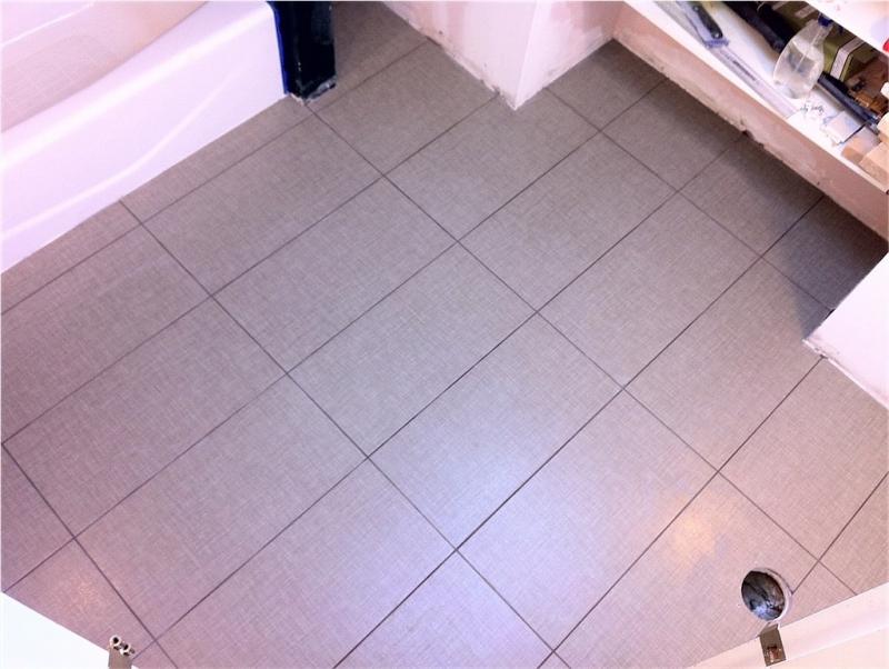

    Floor is now done and grouted.
    Stone backsplash wall is now done and grouted.
    Considering using the leftover stone (0.6 x 6" stone mosaic) as a baseboard strip (a 2" high strip around the edge of the room).
    Problem is that I've already mudded (with non-setting mud) the walls. I'm concerned that thinset will dissolve the mud and the tiles will fall off.
    What can I do to provide a solid base for this thin strip of tiles along the floor?

    I agree--Zinsser 1-2-3 is my favourite primer too. I only need about 4 square feet covered and Prim-Grip's smallest can is 1 gallon so I'm going to see whether the 1-2-3 will work instead.
    In terms of updates, here we go...
    Here's the finished floor:

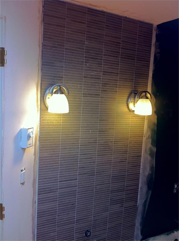

    Here's the finished stone backsplash wall:

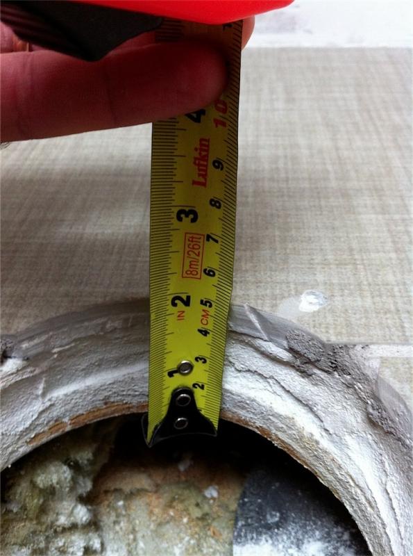

    Here's the opening for the toilet flange -- a tricky cut on the saw. Even though I knew the floor would end up thick, it was shocking to actually see how thick it was in person: 3/4" T&G exterior grade plywood + 1/2" SLC (encapsulating heating wire and plastic lath) + Ditra + 3/8" Porcelain tile:

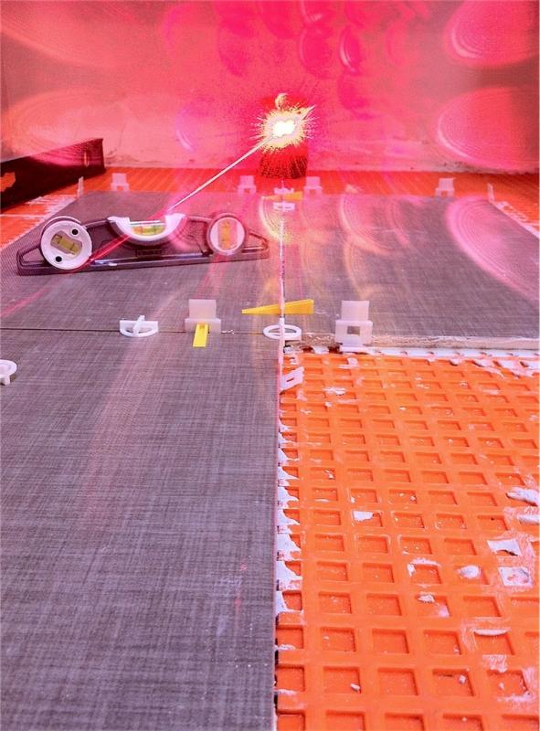

    I used a laser to keep things straight and square. The LASH clips were fine when working off a wet edge, but horrible when trying to continue the next day (I did all the field tiles first, just in case it got misaligned a bit. After 2 days, I went back and did all the edge piece cuts.) With practice, lippage became a non-issue.

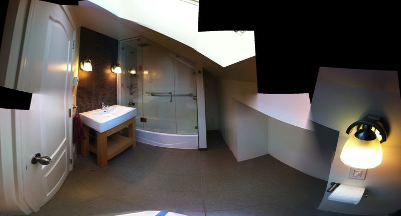

    Getting closer.... Shower glass is in.
    Still to do:
    - final plumbing hookup
    - stone baseboard
    - mirror
    - frosted glass bypass doors (and shelves) in closet
    - seal grout on floor and walls (any recommendations??)
    - John
