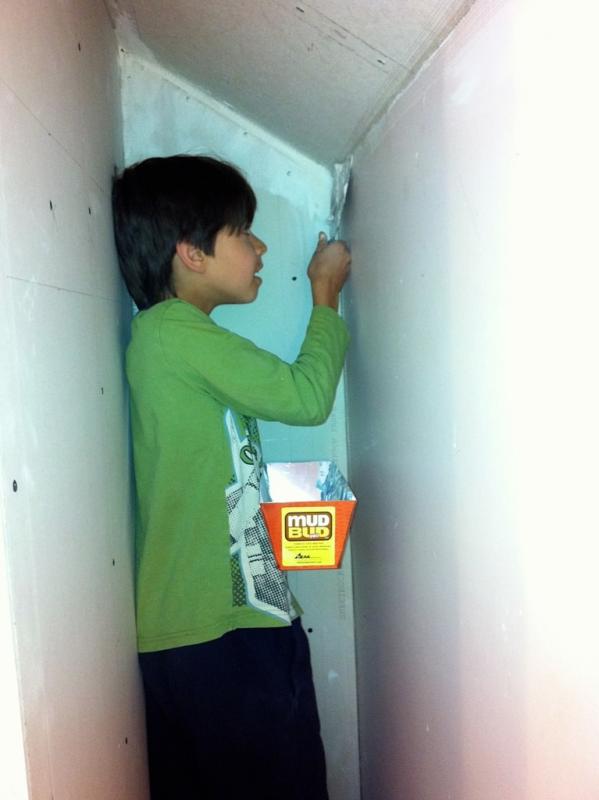

    Sometimes it's super-handy having a little guy in the house who knows how to tape and mud!

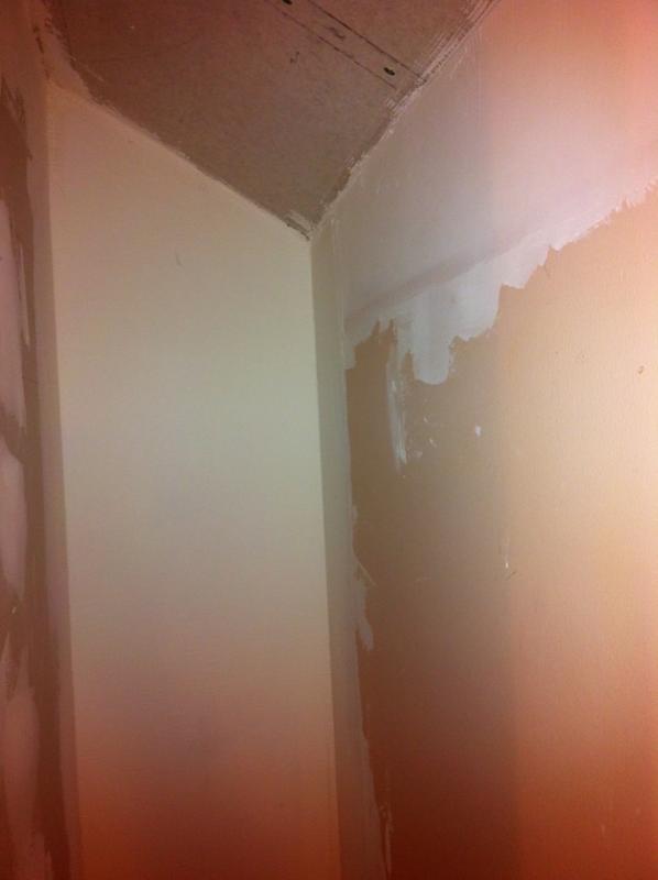

    Ah, ye have no faith in his teacher... The little guy's workmanship is much better than the contractor we let go in December...
    Here's how it looked after the little guy skimmed the far wall, and mudded the wall side of the tape on the right wall. No sanding done yet. Ceiling thinset still to be done.

    14" of joint compound for an inside corner?
    Since you're teaching, show your kid how to hold the knife properly.

    Quote Originally Posted by jch View Post
    John what is this room? Is it a storage locker?

    Wow, tough crowd...
    It's tough to tell the scale from the picture but this is a 13" wide cubby in the bathroom. The mud is one 6" knife-width wide. This area will hold towels etc.
    It's not Child Labour if you don't pay them... they're apprentices...
    When asked, my daughter would always say her favourite part about Grade 6 was working in the woodshop. They used to open it up during lunch to whoever wanted to use it and she and her 2 friends would go in and have the run of the place. She made some really beautiful stuff out of maple, mahogony and oak.
    My son really likes making stuff too. He keeps asking whether he can have the leftover scraps of Ditra -- not sure what he has in mind but I know it'll be cool.
    Everyone has to start somewhere...
