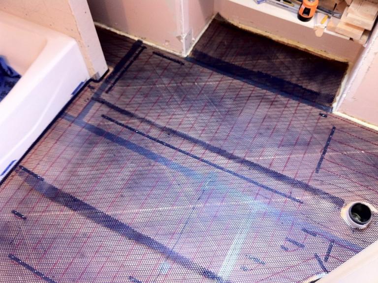

I'm looking at using the NuHeat Solo/220 wall controller (because it seems easy to program without digging out a manual each time). Is there a type of compatible heating cable you'd recommend? I was thinking of using TrueComfort because of the floor attachments and easy availability...
Once the cable heat is installed you might consider a product like Schluter's 'Ditra', Nobel Company's 'Nobel TS' or Mapei's 'Crack and Sound Membrane' over your levelling pour. Remember if you use the Ditra product you will strictly reduce the amount of setting materials available to you. Here in Vancouver the crews I'm working with have been using lots of the Mapei product and many of the setters online have been using Nobel TS. Mostly because they can use the same thin-set to set above and below the membrane.
The original plan was to lay down:
3/4" ply with no underlay
SLC primer
Heating cables
SLC primer
SLC
Ditra
Porcelain Tiles
Do I need underlayment if I use the SLC primer directly on the plywood? Or would underlayment mean that I could do without the plastic lathe in the SLC??

All of the slc installation instructions I've read (and there are some new ones out there I've not read up on) require lath on a wooden subfloor. Ardex has a new one that might not. On large format tile, you may want to look into something like the Tuscan Leveling System or the QEP system (cheaper, since you don't have to buy a special tool and available, here at least, in HD). These utilize a t-shaped strap and a break off bracket to hold the tile in plane while the thinset cures, then you break them off (they break off below the tile) and then grout. On any large format tile like that, you want to burn a thin coating of thinset on the backs prior to setting them (use the flat side of the trowel and really push the thinset into the tile). Done right, the thinset gets pushed into the small pores of the tile, and radically inmproves the bond strength. If you don't push it in enough, the thinset can just roll around on the back of a good porcelain. Flat is critical when using large format tile...even a pro gets slowed down when the prep work is marginal on a wavy floor.

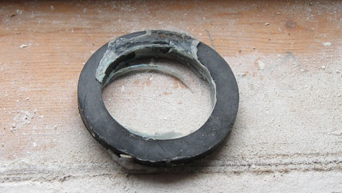

Make sure when you install the tub drain, that you don't put anything on the threads of the lower drain fitting. That works by clamping the metal threaded drain with the lower shoe, and sandwiching the tub and rubber washer in between.
You can put putty under the flange, that is between the tub and metal drain.
Below the tub, is the rubber washer and then right below that the shoe which receives the threaded drain from above.
The drain would seal even without the putty if it's threaded up snug and tight.
The other day I say someone put Teflon tape on the threads, and it prevented the drain from threading down completely and "clamping" the tub. I had to remove everything, pull off the tape, clean things up and then thread it down until it clamped. Even when I explained why I was doing it that way, the response I got was, "It should have worked"
No, It in fact does not work! He had so much tape on the threads that there was a gap below the tub of over a 1/4". The drain had bottomed out with all the tape and it was stuck before it could clamp the rubber washer against the bottom of the tub. Needless to say, there was plenty of water dribbling downstairs before it was fixed.

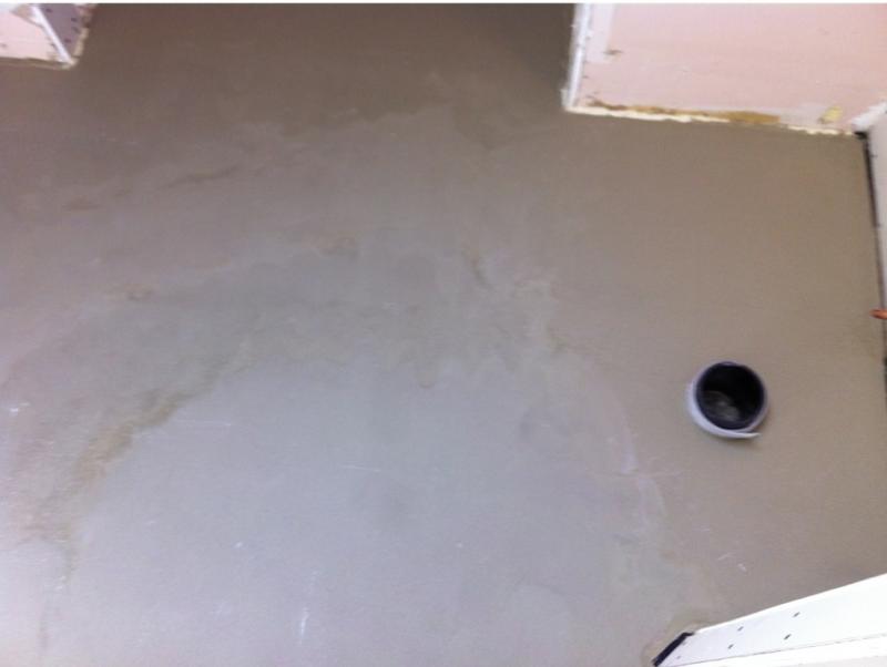

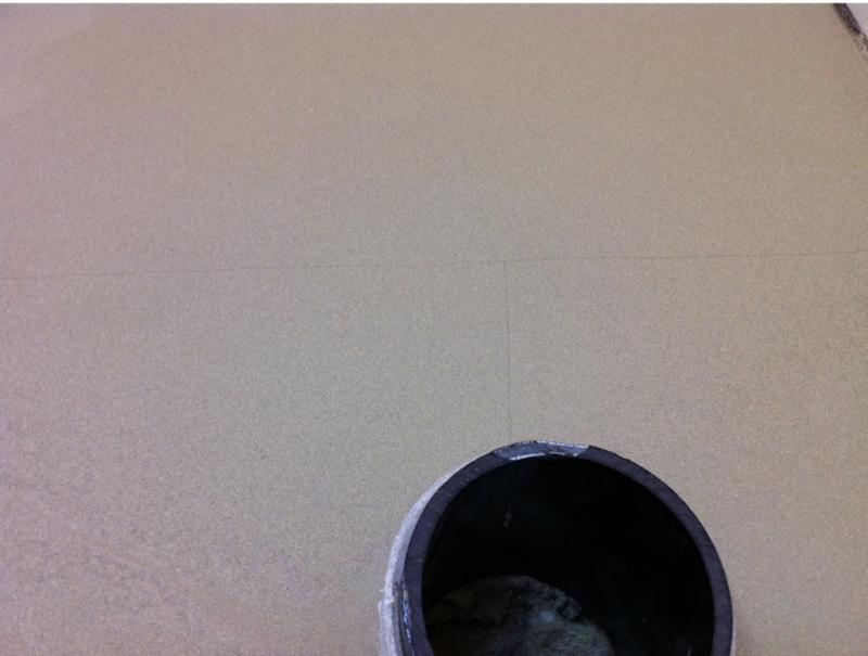

How do you folks recommend getting a SLC install flat enough to install 12x24" tiles??
I was considering putting a skinny (1" wide?) 1/2" thick plywood strip around the outside of the room to rest a screed on. Remember, I'm going to install heating wires and plastic lath first.
Would the 1/2" plywood strip help me make the SLC more level? Would it interfere with the expansion/contraction of the SLC when the heat is on?
