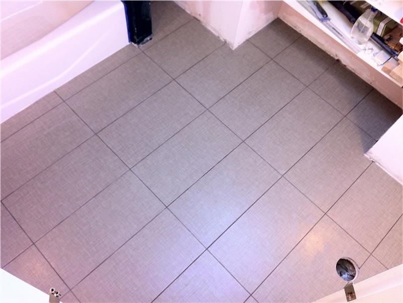

    Floor is now done and grouted.

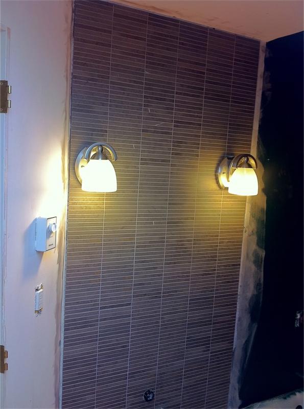

    Stone backsplash wall is now done and grouted.
    Considering using the leftover stone (0.6 x 6" stone mosaic) as a baseboard strip (a 2" high strip around the edge of the room).
    Problem is that I've already mudded (with non-setting mud) the walls. I'm concerned that thinset will dissolve the mud and the tiles will fall off.
    What can I do to provide a solid base for this thin strip of tiles along the floor?
    - Prime the walls first?
    - Paint on a narrow band of AquaDefence?
    - Something else??
    Surely this is a common problem...

    Hi John.
    Lets see some progress pictures!
    If you have drywall compound on the walls already you will not get any thin-set to bite to it.
    I have been experimenting with different primers and found a good one from Mapei called Prim-Grip. I would first give the drywall a primer coat with a latex or oil based dry wall primer (paint kind) - Zissner 123 or Zissner Cover Coat my favourites. For a baseboard detail you would most likely do alright with either one but if you want an even better bond pick up a gallon of the Prim-Grip.
    The Prim-Grip has sand or something in it so stir it very well. This leaves a rough texture on the wall that thinset bites to very well.
    JW

    Here's the finished floor:

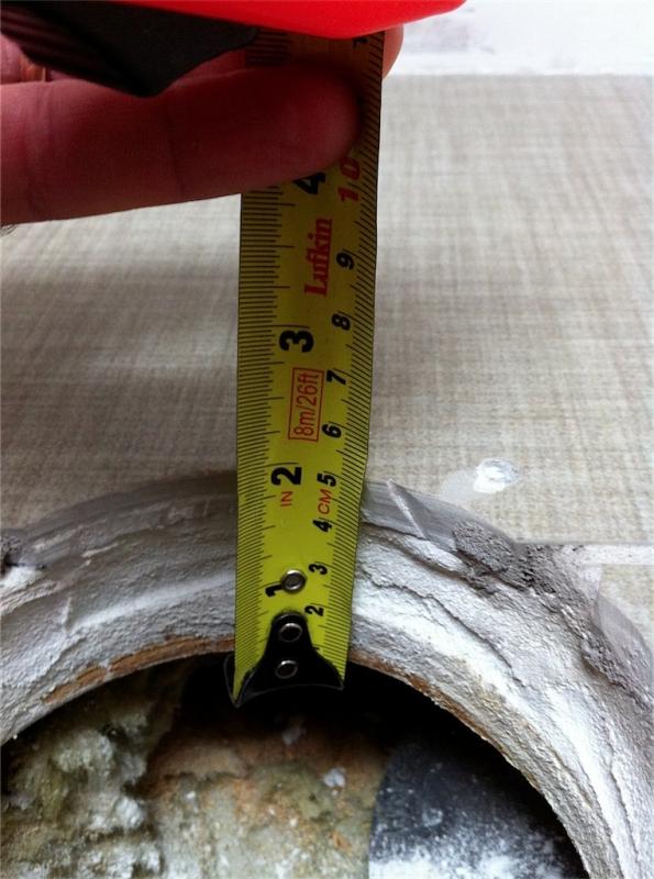

    Here's the opening for the toilet flange -- a tricky cut on the saw. Even though I knew the floor would end up thick, it was shocking to actually see how thick it was in person: 3/4" T&G exterior grade plywood + 1/2" SLC (encapsulating heating wire and plastic lath) + Ditra + 3/8" Porcelain tile:

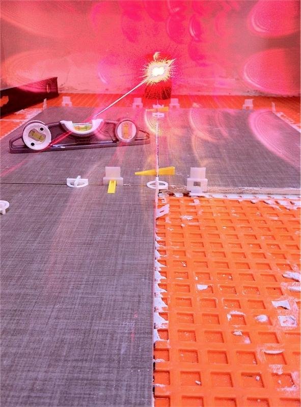

    I used a laser to keep things straight and square. The LASH clips were fine when working off a wet edge, but horrible when trying to continue the next day (I did all the field tiles first, just in case it got misaligned a bit. After 2 days, I went back and did all the edge piece cuts.) With practice, lippage became a non-issue.

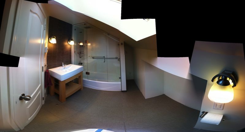

    Getting closer.... Shower glass is in.
    Still to do:
    - final plumbing hookup
    - stone baseboard
    - mirror
    - frosted glass bypass doors (and shelves) in closet
    - seal grout on floor and walls (any recommendations??)

    Looks like a gem John. Love the vanity
