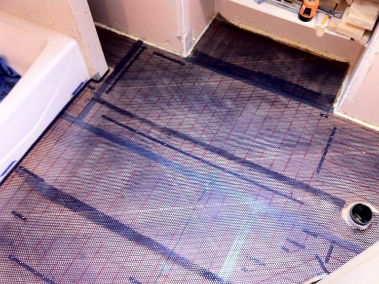

    Here's what the floor layout looked like before the pour:
    Attachment 16611

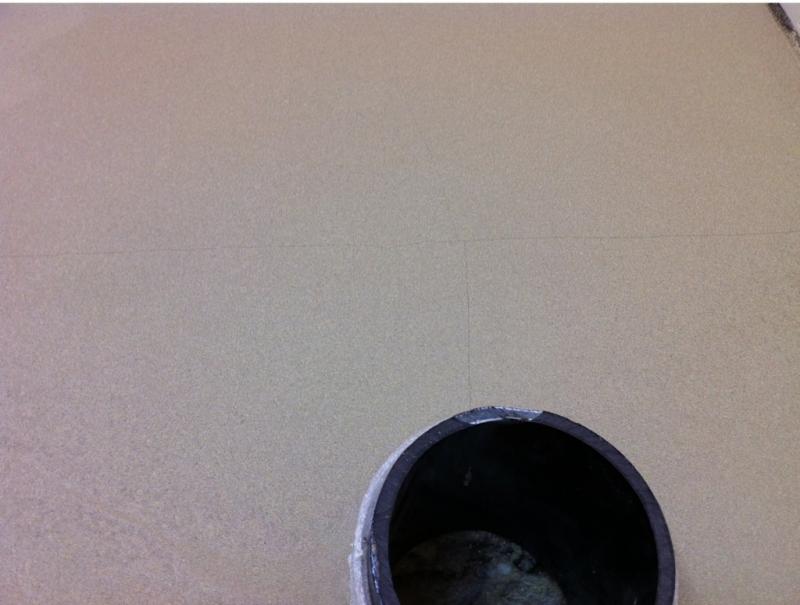

    This area has hairline cracks that don't seem to align with joists nor with wires or any other discernible structure:
    Attachment 16612

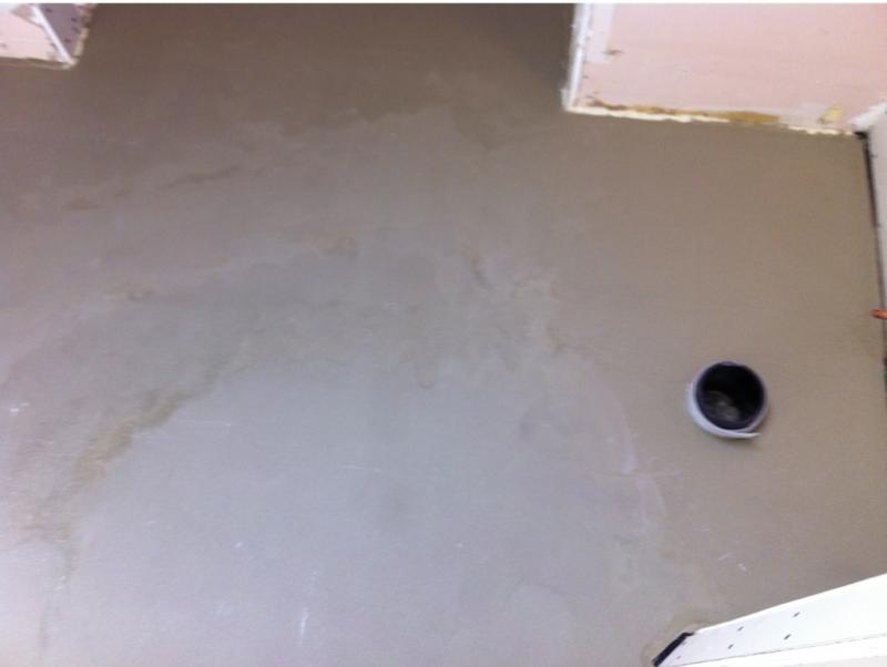

    Here's a close-up of some hairline cracks that have formed near the toilet drain:
    Attachment 16613
    This Novoplan Easy SLC pour was done 3-1/2 days ago. The SLC is 1/2" thick on: exterior 3/4" plywood, 2x10 joists on 16" centers, 8 foot spans (better than 1/800 rating); primed first with Mapei Primer T; mapelath stapled every 2-4".
    Do these cracks looks severe enough to worry about (at this point)?? Knocking on the floor it sounds solid.
    I have not seen the Mapelath go in at the same time as the self levelling stage before. Whose idea was this? Did Mapei recommend it? Is the Mapeilath installed the right way up?
    If your self lever has been installed for a few days and sounds "solid" when tapped you should be OK. Perhaps call Mapei - one of their new reps lives in Victoria and was a setter for years, I'm blanking on his name.
    Some times when you get cracks like this it is a sign of over watering the self leveller.
    You might wait another four days and try one of my rules for tiling. "Never tile anything you can't hit with a hammer". If you give a few well placed blows to the floor (in between heating wires) and you don't blow away your prep or your prep work doesn't crumble it should be OK.
    I tried to follow the TCNA 2011 Handbook and Mapei's Technical Data Sheet as closely as possible.
    TCNA specifies the following when installing Interior Floors with Radiant Heat over Wood (RH140-11, p. 103):
    Name:  TCNA RH140-11.jpg
    Mapei's Technical Data Sheets also recommend installing Mapelath before pouring Novoplan Easy:
    http://www.mapei.com/public/CA/produ...asy_TDS_EA.pdf
    "When applying MAPEI underlayments to plywood flooring, mechanically fasten MapelathTM or diamond mesh on top of the primed surface (meeting the requirements of ASTM C847) before application of Novoplan Easy. Refer to the current Mapelath TDS for installation instructions."
    The Mapelath TDS says:
    http://www.mapei.com/public/CA/produ...ath_TDS_EA.pdf
    "1. Install Mapelath over the primed plywood or OSB. The lath should have a 2" (5 cm) overlap at all seams, stapled flat and uniformly.
    2. Apply a MAPEI self-leveling underlayment at a minimum thickness of 3/8" (10 mm), completely encapsulating the Mapelath. Reference the TDS for the leveler to be used and for in-depth application instructions."
    and "Lay out Mapelath over the substrate ridge-side down. Cut to fit." which is what I did.
    Quote Originally Posted by johnfrwhipple View Post
    Novoplan Easy's TDS says:
    "Into a clean mixing container, pour the required amount of cool, clean potable water. If available water is not cool, chill water to 70°F (21°C). Add Novoplan Easy powder while slowly stirring. Mix water and Novoplan Easy powder to a mixing ratio of 5 to 5.28 U.S. qts. (4,73 to 5,0 L) water per 50-lb. (22,7-kg) bag of Novoplan Easy. The mixing ratio must remain consistent. Do not overwater material."
    I measured 5L of cool water into each bucket (with a measuring cup!) and used a timer to make sure I didn't mix it beyond 2 minutes so should be in the right range. It was a cool rainy day though (about 60% humidity) so that may have been enough to push the water content over the edge.
    I called Mapei again and they said it should be pretty much done shrinking by now (4 days) and that the cracks (too small to fit a piece of paper into) should be fine if the floor feels solid (which it does), but I should put an anti-fracture membrane down (as you folks have recommended).

    Mapei said that the hairline cracks are probably not all the way through the pour--just on the surface. There is definitely no visible change in crack width when I bounce my full body weight near them. My guess is that the hairline cracks are from having slightly too much water in the mix--I used the upper end of the prescribed range but it was a super humid day. The cracks didn't appear until day 3--long after most pros would've started tiling.
    That said, I agree that a crack-isolation layer would be wise. Ditra is available locally by the foot so I think I'll go with that.

    I think those small cracks are plastic shrinkage cracks and you could find similar cracks on almost every single monolithic slc pour if you got out a magnifying glass, no?
