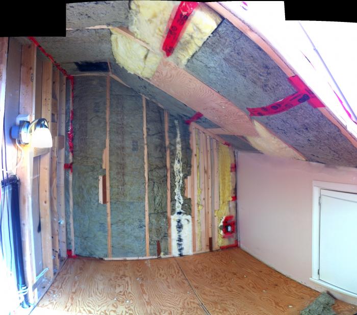

    Question Bathtub installation -- order of installation (end pony wall, tub, heated floor)?
    Here is my gutted bathroom. I have a left-hand-drain Kohler Villager cast iron tub (with apron) that I want to install along the far wall (i.e. along the wall that has exposed insulation):
    The tub is 60" long and the available space is 78" (with a downward-sloping ceiling).
    Questions:
    1) Do I install the tub (on a ledger board) *before* building a pony wall along the non-drain end of the tub? Or do I build the short (20" 2x6) pony wall first?
    2) I plan on installing a heated tile floor. Because the room has some funny angles (not visible in the picture), I was going to run my own heating cables and then pour Self-Leveling Cement. Do I run the cables and pour the whole floor *before* installing the tub? Or do I put in the tub first and then pour SLC on the remaining area? (The heating cable would only be under the exposed tiles, not the tub). My concern is the joint between the tub & SLC, and the reduction of tub-height -- it's only 14" to start with.
    This is my first bathroom reno, so I'd appreciate any tips.
    .../j

    In this case you could do it either way, either set the tub first or install the pony wall first.
    When we install a tub, we put a 2x4 flat; if that is the right height of the concrete pour, and then pour up to that. I don't like setting a heavy tub on concrete if it's that thin. The 2x4 makes a nice resting place for the apron.
    Then you can finish tile up to the tub.
    http://www.terrylove.com/forums/show...-Cast-Iron-Tub

    Thanks for the speedy reply Terry!
    I'm hoping that the concrete won't need to be that thick (for headroom). I was hoping for more like 1/4 - 3/8" thick SLC if possible. Or am I dreaming?
    And does the wooden apron support stick out in front of the apron? Or do you try to install it flush with the front of the apron?
    - John
    12,435
    I haven't installed the electric heating mats, but they may go under the tile without doing too much.
    If that is the case, just set the tub on the plywood.
    You only support at the back wall. One stringer does it.

    The more I think about it, the more I think that I'd better do the SLC last. I *know* I'd end up dropping something on it while wrestling a cast iron tub around the room...
    So how does this sound then:
    1) Build 2x6 pony wall along non-drain end of tub
    2) Install wooden 1x4(?) along floor where tub apron will sit
    3) Install 1x4 or 2x4 ledger along wall (depending on clearance of tub), measuring up from top edge of apron support
    4) Skid/rotate tub into place using instructions here: http://www.terrylove.com/forums/show...-Cast-Iron-Tub
    5) Install in-floor heating cable
    6) Pour SLC to bury cable
    7) Install Schluter Ditra anti-fracture membrane on top of SLC with thinset
    8) Install floor tiles
    Sound good??
    - John
    12,435
    You have enough room there that you may be able to just slide the tub in.
    But either way, so far, so good. That looks close enough for a plan.
