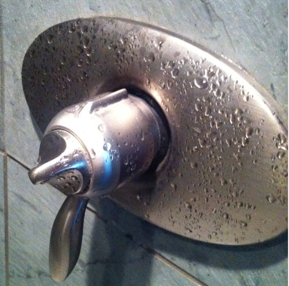

Squeaky Hansgrohe shower valve
Tfield98
10
Seattle, WA
Our two-year old HansGrohe shower valve works fine, but has begun to squeak when we turn the flow lever.
Any suggestions?
Is this a DIY project to repair?

Hello,
The squeaking from the cartridge is due to the dissipation of the lubrication between the ceramic disc inside of the cartridge. Please give me a call at 1-800-334-0455 extension 6960 and we will resolve this matter promptly for you.

Hi,
I have the same HansGrohe shower valve. Can I change it to a new one? Please recommend which one, since I can't find exactly the same one.

You sure it has nothing to do with the check valves being clogged ?

Hi Neil,
Thank you so much for replying to me. I found out the trim model number and now will just have to open it up to see what valve i actually have inside (hopefully it's an Ibox so i can just switch the trim to something newer). Having someone coming tomorrow to check and see if we can just clean it up without having to replace the whole system. I will keep you posted, for those who might have a similar issue, i'm sure there are not many left.

shower valves tend to stay in wall for half a century sometimes more . but 30 years is pretty normal most are brought back to like new condition with a cartridge change , but I haven't worked on a Hans Grohe in ages and can't say if they are prone to problems requiring a complete replacement or have any info on their quirks

Hi Victoria,
I for one am glad you opened this old thread, because I have the same shower faucet and cannot find any info about it anywhere! My problem is the temperature control knob is extremely difficult to turn, so I thought if I could just clean it out a bit, it would help. I found the set screw and removed it, but it has proved a challenge to remove the handle. Maybe I need to apply a bit more elbow grease? I obviously do not want to break anything. Does it simply pull off? May I ask if/how you were able to dismantle it? Thanks!

Google brought me to this old thread with the same issue regarding difficult to remove handle. I've removed the set screw. I have removed all the visible scaling with vinegar. I can not get the handle to come off with force I'm comfortable applying. It seems to hit a hard stop when the diverter handle edge farthest from the wall is about even with the temp control knob. Not sure if it needs to get over a snap ring, o-ring or what's going on. I'm trying to apply even pressure and not removing at an angle. Does the diverter handle need to be in a specific position? Help! Thank you.
Once the Allen screw is removed, you should be able to wiggle the handle off he splines of the cartridge stem.
3 mm Allen wrench (included with trim kit)

Thanks. More vinegar and time to soak. Perhaps some scaling on the cartridge splines because it's not coming off. Thanks for the cartridge pic. Let's me see what I can't see.
