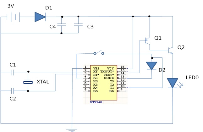

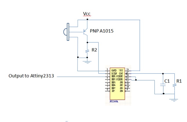

    Recently i build a IR communication circuit and still fails to figure out what went wrong..
    I hope can get your expert help on this. Below are component list and attach files is my circuit schematics. Please help and this is urgent!!
    TX IR Component List
    - C1 = C2 = C3 = 120pF, C4 = 10nF (Polarized Capacitor)
    - XTAL = 455Khz
    - D1 = IN4002 and D2 = IN4148
    - Q1 = Q2 = PNP A1015
    - LED0 = Infrared Transmitting LED
    RX IR Component List
    - C1 = 100pf
    - R1 = R2 = 39K
    - 1738 IR Receiver (38Khz)
    - PNP A1015
    - Receiver IR Sensor

    The output going to the 2313 has to be at least 2 wires, Your drawing only shows 1.
    You would need a ground return path for that output feeding the 2313 microcontroller.

    Sorry not details given. Below are ideal IR transmitter design stage; But after i build up whole IR transmitter circuit, i found that IR LED no voltage due to Q2 Transistor Emitter no voltage (Base and Collector have nearly same to 2.5v).. i not sure it is design problem or somewhere connection wrongly..
    Operation Mode
    - This circuit only require 3v DC Supply. 3v Lithium used for this design.
    - C4 used for power supply filters purpose.
    - When switch is open, the whole circuit in very low power or sleep mode to achieve low power consumption. Whole circuit only operate mode during switch close mode.
    - IN4002 Diode applied reserve voltage 4v DC to work act ensure current flow in one direction and block the reverse current flow back.
    - IN4148 Diode used for high-speed switching and used to trigger C1 (T1) to be “1” which able to communicate with IR Receiver through matching serial code bits.
    - From the PT2248 datasheet, basic transmitting waveform consists of 12 bits serial data (3 code bits, 3 single short code and 6 keys input code). Carrier frequency is dependent on the oscillation frequency (Fosc) and is given by following formula;
    A= (Fosc/12) Hz
    So in order to get 38Khz, 38*12 = Fosc = ~455Khz (XTAL) must be used.
    - When (TXOUT)’ in high (1), Q1 transistor (PNP) emitter and base reverse biased so emitter and collector act as open circuit. No current flow into Q2 transistor and LED0 is in Off Mode.
    - When (TXOUT)’ in low (0), Q1 transistor (PNP) emitter and base forwards biased so emitter and collector act as close circuit. Current flow into Q2 transistor and LED0 is in ON Mode then signal will be transmit to IR Receiver.

    If Q2 has 2.5 Volts on Collector and Base, then the emitter should have about 1.8 volts, and the LED should be on.
    That is if the transistor is a NPN installed properly and is good.
    I would double check the pin out, because it sounds like it is not inserted or pined properly, wrong type or is bad.

    The fact that the transistor is not conducting is the first problem.
    That needs to be corrected first. There could be other problems also.
    When a sub part is used, then the EBC pins are sometimes swapped, depending on the Package type and manufacture.
