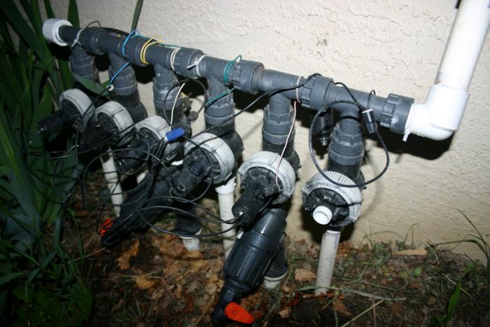

We moved into a house with a Toro irrigation system. The valves installed are Toro jar top inline valves (53708) (see attached picture). Is there a trick to installing the solenoid. It screws in fine if I take out the solenoid plunger, but with the plunger in, the threads just don't make contact.

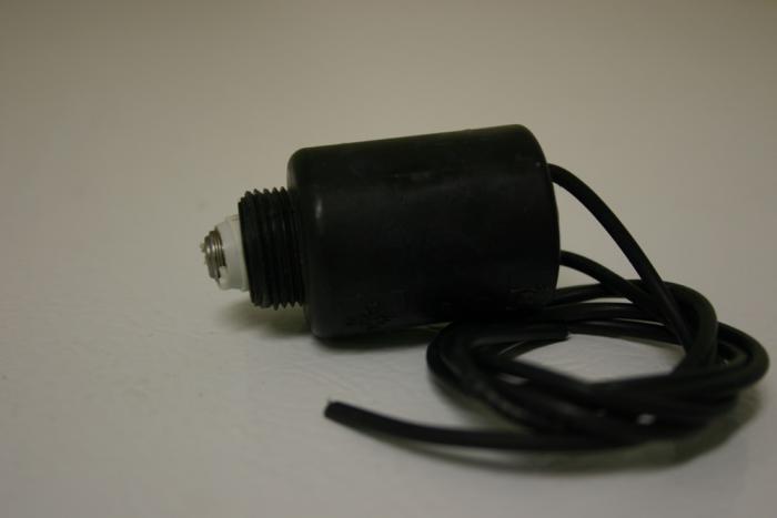

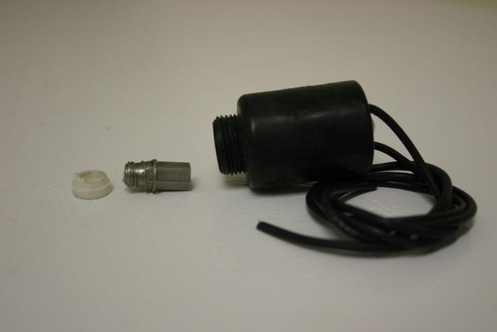

The weird thing is that it is not a new solenoid. It's the same one that was in the valve last year when the system was working. I checked out the toro 89-0114, it looks a bit different than the one I have. Here are some pics.

I will try installing it without the cap tomorrow. Right now it's dark and I will get eaten by mosquitoes. What is the cap suppose to do? They seem to break apart very easily.
