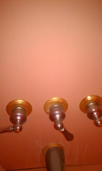

    Here is a pic of the faucet set currently on my tub. I might be able to clean up the handles but i need new internals and trying to track down what the model of these are.

    PP still makes 3 handle faucet sets, but they have ceramic seals. If I were repairing it, unless you wish to change its appearance, I would just convert it to "lifetime" ceramic seals, (do NOT try to do this yourself or you may end up replacing the entire faucet or destroy the new stems), and reuse the existing handles and trim.
    9,003
    PP 3 handle valves are extremely common. There are a few different stems, which vary only in the length of the stem and how the sleeve attaches. The new models all use the ceramic stems. Just take out your stems, take it to a good plumbing store, maybe even the local hardware store. They will have the parts. If it is the rubber washer type, you will also want to replace the internal seats ( they unscrew)

    actually the only handle i really need to replace is the middle shower stem. I was going to take it all the way out and take to a plumbing store. Can that stem be removed without needing water shut off?
    9,003
    Yes...just don't turn on the water while it is out!

    well. After pulling my hair out! The diverter is a compression type. The hot and cold are cermaic type. Replaced all 3 stems. On the diverter i also put a new seat seal in and when going from shower to tub and vice versa i get a little drip. Is there anything else i need to check.
    9,003
    The key component of the diverter is the white nylon gasket behind the nose. If it is bad, you will get flow from the tub when using the shower.
    It is normal to have some dribble after turning off. How long that lasts depends on the shower head.
    If you get dribble from the shower head when using tub spout, that is due to excess pressure in the house, probably. The black rubber washer on the diverter stem, and the in-wall seat, are part of it but usually don't cause much trouble.

    OK. I have two white gaskets. One is by the threads that thread into the behind wall plumbing and smaller one down near the stem. Is the further one the one you were refering to as the neck?
    Frank
    9,003
    Yes...the outermost gasket it called the cap gasket...seals the body of the stem into the valve body. That one down near the "business end" is a back seat...when you turn the handle CCW for shower, the nose of the stem seats back against that, blocking the port where water can travel down to the spout.
