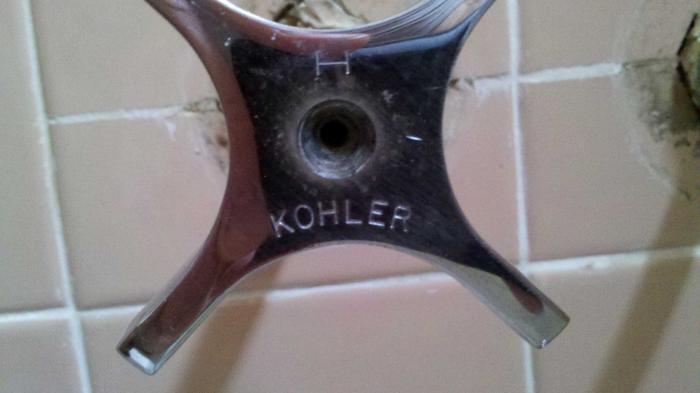

    Thanks, I got the escutcheons off. I figured they spun off, but they were on there pretty good so I wanted to make sure.
    I think they are Kohler based on the name on the handle.

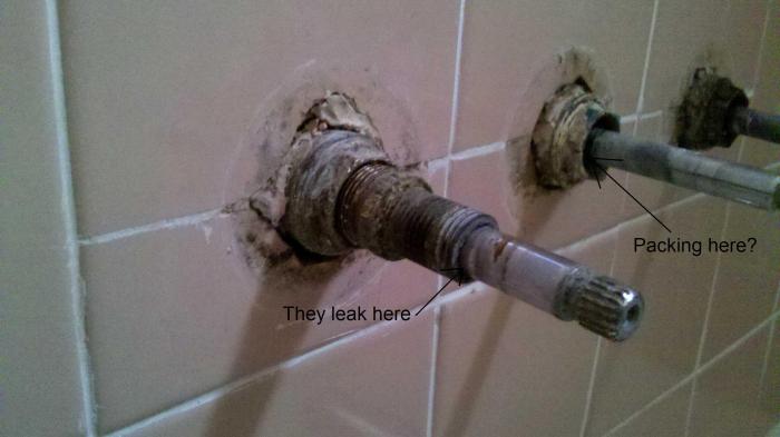

    All three of these leak a bit around the stem. Is there a specific type of packing or washer that needs to be used or is cord packing used? I don't think I can get the entire valve off without damaging them or something behind the wall. They don't leak when they are off.
