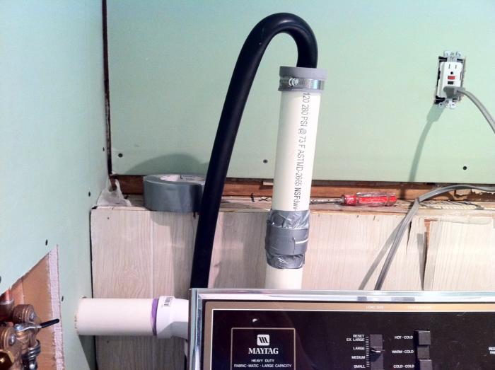

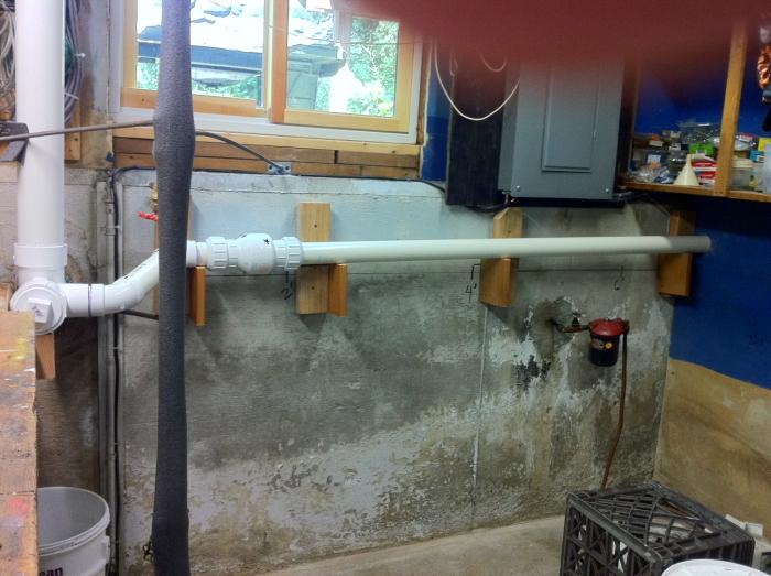

Ok attached are the two pic's
#1 is 3" main with 2" coming off
#2 is the 2" coming through wall directly behind washer. Note the "Tape joint"
Last night I got a 2" coupler and another 10" of pipe to try and extend the stack to about 18" I didn't glue it just used duct tape as a temp
Bill
renman
Thanks, I thought about a AAV, but figured it wouldn't need it since normally the pipe end is open.
Can't risk getting rid of the check valve, that 3" main comes from the upstairs, 2 toilets, 1 shower, 1 tub/shower, kitchen...
That could be just an incredible mess in the worst case senario.... I can take the water.. the other stuff that sometimes comes with it..not so much.
Thanks
