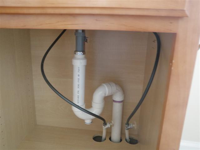

    I did a home inspection on a flipped home where they had a licensed master plumber but in a new bathroom. I hit them on the S-trap under the bathroom sink (first picture)Name:  P1010205 (Small).JPG

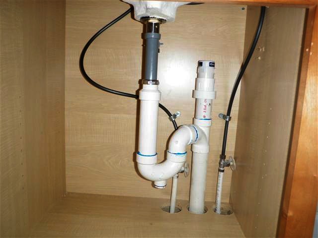

Size:  27.7 KB. The agent asked to have the S-trap changed to a P trap. The second picture Name:  P1010190 (Small).JPG
Size:  44.3 KB shows it is now an S trap with a vent. I also reported the vent stack is too short because it's below the drain flange.
    By the way. They could have used a regular plumbing vent through the roof but they didn't.
    Can somebody tell me if this plumber is all washed up?

    I have a similar setup under my kitchen sink......
    I installed it myself.... It never had a vent before and was an S trap and always drained slow.
    There was no way to get up thru the roof with a proper vent. The drain is in the floor not the wall and the sink is on the first floor.. so I added a Studor AAV. Mine is above the bottom of the sink and the trap arm is longer....
    Mine sink drains perfect...no smells.....5 years at least working fine.....

    In many ares studor vents are legal. The only requirement is that they are accessible. They do not have to be above the flood level of the fixture.

    The mechanical vent is allowed in some places and not in others. IMO, it makes sense to use one when installing a real vent is not cost effective for a remodel, but I believe it should be avoided whenever possible.
    IMO, one improvement to the one in the picture would be to get the vent up as high as possible under the cabinet to help prevent it from becoming contaminated if their were a minor back-up. If any solids get stuck up in the AAV, it will not seal and then the sewer gas will be leaking in.

    Hi all:
    I don't know...I see this as a vented STRAP. I mean, doesn't the vent have to be at least 2 pipe diameters from the wier of the trap? Here, that would mean that the trap arm needs to be a minimum of 3 inches (1.5" pipe x 2), otherwise, it's an STRAP, right?
    Also note that the manufacturer's of AAVS only require that the AAV be installed a minimum of 4-6" above the crown of the trap so the height of the AAV is OK, but I do agree with Cacher_Chick that the AAV is better up higher, for sure!

    quote; would mean that the trap arm needs to be a minimum of 3 inches
    The DISTANCE between the trap's "U" and the riser would have to be 3", not the branch pipe itself. IN the second picture, it appears that the water lines "grew" since the valves are now higher above the floor than in the first picture. If the original "plumber" installed that "S" trap, then he was NOT a very good plumber, assuming he was actually a plumber in the first place. but then, how many "flippers" hire professional tradesmen for their projects. They look for low price first, and accept whatever quality they get as a bonus.

    the distance from the trap ell to the san tee needs to be twice the pipe diameter or you have an s trap
    The height of the AAV is fine although I like to get them as high as possible.
    I doubt that a licensed plumber did the work. How many plumbers use blue waterproof glue on an interior joint?
    Nice PEX job also. So neat and professional looking LOL
    Ever wonder why the trade is dying? Perfect example above. Nobody gives a crap what things look like as long as they work which by the way the S trap in the first picture would have worked just fine, just not to code.
