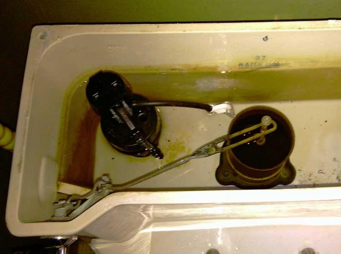

    Here is one I don't normally see. A one-piece toilet with a strange looking flush valve. It's leaking, so I need to find parts. This is a picture that a customer sent.

    I'm thinking American Standard 2149

    It converts to the "tip flush", I believe #4. The replacement has three rubber plugs to seal the bolt holes, and attaches with "toggles" through the center opening.

    Also the over flow is below the handle.
    14,191
    Yes, I was looking at the fill tube, I would think that whoever did the work before should have directed it to the overflow under the handle. Though since it's been years since I've worked on one of these in person, I'm not sure that it "has" to go there.
    Most likely it should. I'm still trying to find original pictures showing it complete with the old ball on an arm style fill valve.

    The original fill valve had a copper or brass refill tube,and did not need a clip.
    I worked quite a few of these and was the only one in the shop that could take them apart.The kit HJ posted works good.
    As far as the refill tube goes I made clips out of guide wires and siliconed the to the over flow,not the best way but keep the tube in place.
    25,605
    Some of the newer tanks had a hole in the ceramic above the overflow for the refill tube to slide through. A Fluidmaster clip can be "bent" to grab the wall of the overflow. Without the refill tube into the overflow, it is problematical whether there will be enough water in the bowl at the start of the flush to perform properly.

    It originally had a plain brass ball cock with a float, similar to an Indiana Brass one. They were generic to all the the companies tanks at the time. And since they fit ALL tanks, they were like the Fluidmaster of their day.
