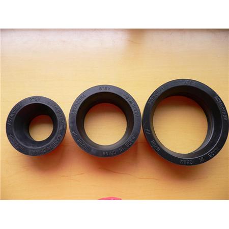

    2) install a compression donut of the appropriate size, soap up the gasket and push the ABS into place (more like drive the ABS pipe in using a piece of wood and a hammer)...see image of the compression donut. The ABS pipe edge should be slightly beveled at the end to push in and seat properly.

    Shame...pretty common in my area! If the local plumbing supply store doesn't have them (still hard to believe) then you may do well to check at the local home depot...fernco makes these, too and most home depots seem to carry them. If you do find a donut and you find that it is a sloppy fit it is possible that you have an EXTRA HEAVY (XH) cast iron hub (as opposed to service weight (SV) cast iron in most homes) there in the ground and you will need to find an XH donut, go with the soil seal, or hire a pro. to pour a lead joint.

    Fernco sells a huge number of the donuts in various sizes. Most places only stock a couple, if that, for the sizes usually used in your area. But, since there is no standard on the size of a bell on a CI fitting, each foundary made their own choices. That's why Fernco makes so many in slightly different dimmensions. The inside hole is standard, as the PVC or ABS has a standard, but the OD varies by the foundry and often the year of manufacture. It is important to get the proper size to ensure the seal is good. Too small, and it won't seal (OD); too large and you might get the plastic pipe in, but you might not, either. Just like the three bears...you want 'just right'!
