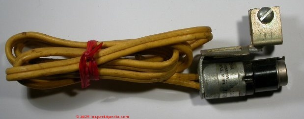

    I found in my stack of manuals were you can pull the CAD cell and check for resistance with room light vs dark. At room light, it's supposed to read < 10k ohm so I set my tester to 20k and it read 3.89 - 4 on the pins at the back of the cell so that checks out. At dark (I put my thumb over it), it's supposed to read > 50k ohm so I set the tester to 200k and it read between 57 and 58 so I believe that all checks out.
    There doesn't appear to be a wiper or anything on my setup and other than the yellow wires on the F terminals on the primary control, I can't get to the ends of the wires on the eye because they're integrated into the unit. I can only see the pins on the back of the CAD cell and those were clean when I pulled it.
    It looks like this (except the eye part doesn't have the silver band at the top and has the numbers 21K1757 and 1024 on it)
    Also, when I made it call, it crapped out again but when the PV and motor (was running, I got 2.7v on the F screws on the primary control). It went in to lockout and still I got 2.7v on the F terminals. After I reset it and all was running normally, I am getting .3V on the F screws.
    As for the motor and all that, I don't have that pre purge. The argo panel gets the call, the PV comes on and almost instantly, I get the big "woosh" of burning flame when all is normal. When it goes into lockout, I am definitely hearing the motor during the 45 second pre lockout period and after lockout. I've also been able to hear it during normal operation so I would say the motor is turning normall at all times, it's just that unless I am starting it by hitting the reset, I never get the "woosh" of ignition.

    If your oil burner has a fuel valve with the solenoid, check for 115VAC on the coil wires; the more we go over this, the more it seems like the primary control is the culprit. If the motor turns the pump and blower, all else required for flame is fuel and ignition. If the ignitor is bad or the fuel solenoid is bad, the problem would probably not be so consistently repeatable as you have it.
    Bear in mind that my advice is from a DIY homeowner with some experience on this stuff, but I don't want to make you buy a new controller if its not needed. Then again, "I" have a spare part for everything in my burner including the blower wheel, pump coupling and air tube with "nose cone", fuel filters, screen; everything other than the main casting . In the middle of the Winter, if my system went out, I just want to get it going again ASAP.
