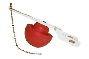

They have a pretty mint green 1950's Eljer reverse trap toilet. There is no flush valve in the tank as the toilet's tank has a built in overflow tube molded into the back of the tank. On the inside front of the tank is a porcelain bump-out that has a small hole through it that for a brass lift wire guide to screw into. The end of the porcelain bump-out disintegrated or broke off, and there is nothing to guide the tank wires for the tank ball. Whenever you flush the toilet, the tank wires and ball float freely throughout the tank and never settle down on the bottom of the ceramic flush valve opening.
Is there any type of fix for this kind of tank? Can this tank use the Eljer "Touch Flush" flapper that you can attach to one of the tank bolts - that was so commonly used in 1970's Eljer toilets? Can you use one of those FluidMaster set and seal flappers and affix it to the porcelain opening of the built in flush valve?

Touch Flush?
Korky has a flapper for that.
http://korky.com/Flapper62BP.html

Thanks for the reply Terry! Would you just glue the fluidmaster flush valve/flapper thing right down on the porcelain inside the tank. The directions on the link show how to glue it to a metal flush valve body. I would think it would come off if it was glued right to the porcelain.

Thank you so much for your input and advice on how to fix this toilet. My neighbor is going to use the Fluidmaster "glue on" valve seat for his toilet. He originally was going to try to use the touch flush (which we believe will work), but after looking at the tank bolts, he decided against trying to dismantle the entire toilet. Better to leave well enough alone. I'm not doing any of these repairs as I don't want to be responsible for breaking his toilet!! So, right now he drained the toilet tank and is letting it totally dry out for a day or two before he glues this flush valve down.

it will work
tell your neighbor to totally dry out that china or it will only work for a week or two.... we have had that problem when they are this old
we have tangled with a few of them over the years,
their is a better way to use the fluid master glue down type seal...
you throw away that epoxy sealer that they give you and use a tube of water proof SILICONE to glue the flapper down with....
it will take a day or two for it to set up , but once it is dry , it will work forever ,, where the epoxy bond can sometimes give way....
also , DO NOT make the chain tight or it too can pull it out of the socket it is glued in...

It is still a temporary fix.It will come apart in no time at all.Best option is to install the touch flush system.
