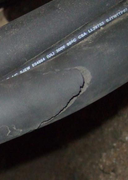

    Since underwater splices are made with rubber splicing tape and then covered with scotch 33 it sure seems that would be safe on this wire.
    no no no no no
  2. #17
    Mar 2011
    Houston, TX
    2,200
    I agree it would be safe.
    It is safe now as is, because the cable sheathing is cut back when you terminate the connection, normally.
    And if the inner conductors are not nicked then the outer sheathing plays little role in safety.
    It just keeps the conductors together in one bundle.
    But Up to Code ? Depends on the inspector.

    That's funny, I realize you are a plumber and probably install these systems all the time, but every one I have ever wired (and that is a lot of 'em) has sent line voltage between the units.

    Also, if you look closely, it says "600V" on that cable in the picture. That is definitely line voltage cable.
    Actually it looks more like cord, which means it is unlikely that that is an actual image of the cable used.

    I am familiar with LG and Friedrich. In poking around on line, I did find that Mitsubushi and Sanyo do feed line voltage from out to in...
    I am still curious about that cable he showed in the pic. Does it look like 14 or 12 ga? or smaller?
    The writing on it says 14/4.
    Around here we need to use #12 AWG wire for 20 amps.

    The pic is not of his wire. He just grabbed a pic off the web. Here is what he said:
    I've attached a web image that will give you an idea what this cable looks like, but mine looks like it has another black jacket underneath the one that's torn.
    It would be best to get a pic of the real install. It may need a new wire ran or the problem area may be able to be placed in a junction box and ran from there (assuming it would be accessible).
    This is not the circuit conductor cable. It is feeding the outside unit from the inside unit.

    Quote Originally Posted by nukeman View Post
    Or, since there is just a small 1.5" tear in just the cable jacket, it CAN be repaired with electrical tape.

    Sorry guys didnt mean to start a war!
    Actually after taking a closeup of the cable it's apparent that the installers used the wrong cable. The cable they used says SJEW E54864 (UL) 300V 90*C CSA LL39753 SJTW(TPE). The install manual calls for 600V insulation on the cable. BTW its a Mitsubishi.Name:  Power-Cable-Closeup.jpg

    What war??? All I see is a discussion.
    Why would they call for 600V cable? the only difference between 300V and 600V cable is the jacket thickness. 600V cable like that is for hard usage.
