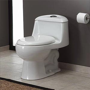

    Question Foremost Gemini 2100
    Does anyone have experience with the Foremost Gemini 1 piece dual flush toilet?
    http://www.foremostcanada.com/products.php?prdid=243
    Specifically, I am curious about ease of installation, flush mechanism quality, sound, and water spot. I like the looks of this better than the other dual flush toilets I've come across (e.g. TOTO Aquia). I know TOTO is the top of the line but maybe this one is passable? Thanks in advance.

    I have not seen one installed, i have dealt with Foremost and have heard good things about them.
    They are a Big Box distributor and sell to mostly all of them, i don't see parts as being a problem to get. The Map test on the TL2100L is 1000 so it seems to be a very good flush.
    The water spot is unknown to me i have never seen one.
    Toto does not make an 1pc Dual flush.

    Gary - I've been reviewing toilets off and on for a bit on this site so understand where you are coming from. I am cognizant of the quality of the Toto product and having done business in Japan, can definitely appreciate it. I have seen an Aquia first hand and was not 100% happy with it. Primarily, the small water spot is something I know my wife will not like and as you said, it is something you have to live with for 30 years. The Gemini has the look & features we want in our bathroom (modern, 1-piece, & dual flush) and actually the price is about $150 more than the price I've found for an Aquia in Cupertino, CA. But I haven't seen a post for it so figured I'd ask in case someone has some firsthand experience with it.
    9,003
    Foremost North American HQ is in Canada. They are the company who provides Glacier Bay toilets to HD, and apparenty several other "no name" builders toilets.
    The issue has always been availability of parts ( forget it!). Quality is OK, but I have not seen any of their models in the high flushability end of the charts.

    So I ended up going with the Eco Ultramax one piece at 1.28 gpf, installing it last Saturday. I purchased it for about the same price as the Foremost Gemini. The looks are about the same, the waterspot looks like a normal toilet, and it has performed great (no 2nd flushes and is quiet (at least by our standards & compared to our old cheapo 1.6 gpf Am Std but in by previous owner). Given that th Eco Ultramax is 1.28 gpf while the Gemini is 1.1/1.6, we are saving more water. I didn't see the 1 piece, Eco as an option before so glad I did more research here on the board. It fits our modern, Eichler home perfectly! Thanks everyone!

    I have had a Foremost Gemini toilet for two years. I have just replaced the fill valve; I had a three-year warranty. The (rubber?) seals were surprisingly degraded. I have three other toilets (Toto and American Standard) in my house and they show no such degredation whatsoever. My water is from a city supply and is soft. I'm now concerned that the flush mechanism may fail because of the same problem. Other than that, it works well.
