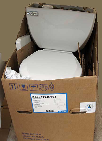

Here is a almost new Gerber Ultraflush that was replaced with a TOTO Ultramax.
The Gerber works fine, so James will be finding a home for it.
The homeowner wanted something a bit less noticeable when flushing.
